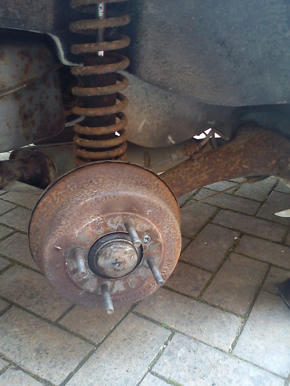

Have been working on the rear wheels and breaks too. Not too sure if I'll strip the paint off the wheels and refurbish them myself or get another tidier set off ebay. The breaks seem to be good so far I've found it's had new drums fitted at the rear

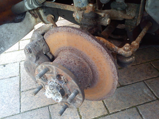

Front suspension is being stripped currently and I've cleaned up the years of grime and rust. As we speak I've had some parts in vinegar for 24 hours but I have to say I'm not impressed at all with this method and will not bother using it on any other bits, a wire brush is far more effective and 100 times faster too.

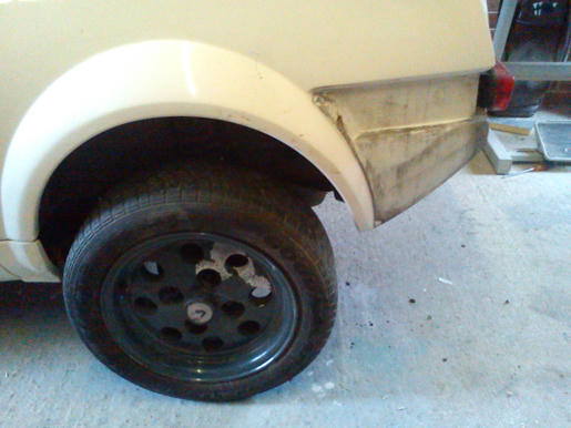

I think I already mentioned that I've been doing a bit on the rear suspension too which is really easy to do. I do need to sort out a lower rear ride height though as it's sitting far too high and really does look silly now on the new wheels I've got for the car, though they are not fitted yet as I also need to get some different spacers too.
^ new wheels
v old wheels
Any recommendations regards rear springs will be gratefully received has anyone else changed the ride height on theirs that can remember what springs they got?

Here's a photo of some of the parts from the front suspension after I've had a good go at them with a sturdy wire brush fitted to my grinder. I did also leave the parts soaking in vinegar for about 60 hours in all but to be honest the wire brush did 99% of the work if not more.
You could lower it a bit using a shorter main spring and a run-flat if you want to retain your dampers. Midas spec Gaz dampers are too long for the mk 2, there is a photo at post 9 of the Gaz in full bump on 165/60x12 still showing a 2" gap.
http://forums.delphiforums.com/n/mb/mes ... 4.1&maxT=8
I liked 110lb springs on my mk2.
