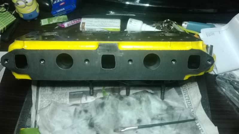

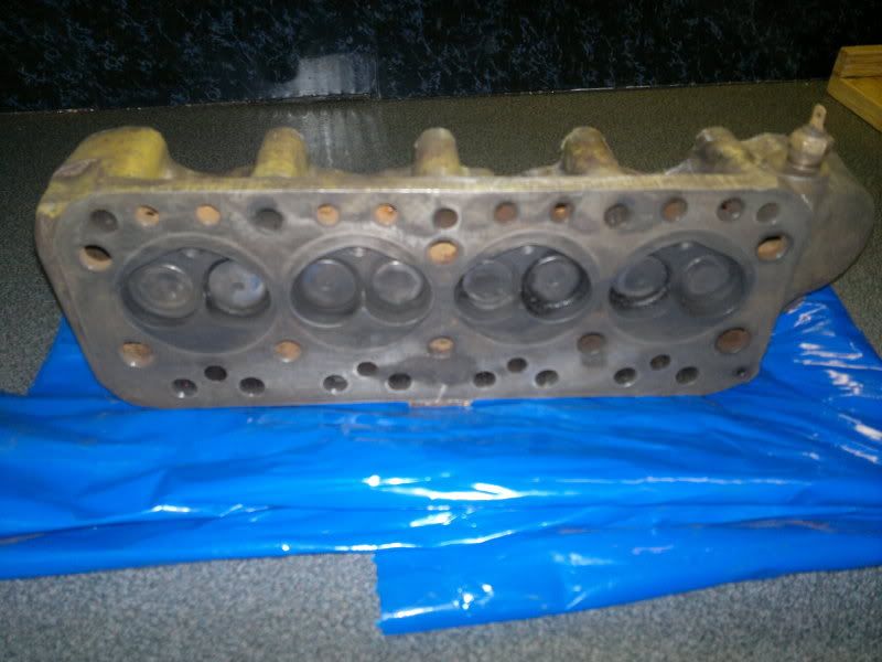

To keep me busy I dug out the cylinder head and gave it a once over with my Father-in-law Steve's evil degreaser. This made it a fair bit cleaner. I then dried it and gave it its first coat of paint to match the block. Hopefully I will be able to start lapping in the valves soon.
Backplate with locating lug on wrong side. Drill sorted this.
Lovely new brakes with lots of new parts!
Dirty head, ready for a clean.

Not very presentable, but a LOT cleaner.
First coat of paint. Looks SO much nicer!

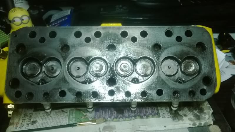

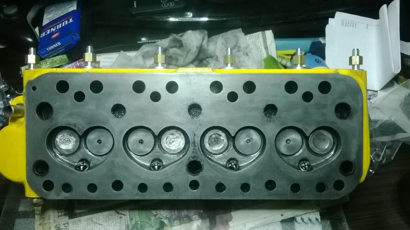

As I had a few hours' free it was time to get lapping. No, this doesn't mean a jaunt to the local naked ladies' dancing bar, but instead some incredibly tedious work with some grinding paste and some new valves and seats. And as I had everything else that goes with them, I also built up the head.
I have decided that I also don't like my valve spring compressor. It's got a stupidly short handle which means unless you get it at EXACTLY the right angle that it likes working at, it is virtually impossible to use properly. Still, I was eventually able to add the new stem oil seals, compress all the springs, and popped in the colletts with a dab of grease. I am glad I don't have to do that again...

Valve-less. That soon changed...
Inlets in.
All in and looking good...

Postby MrBounce » Thu Jan 30, 2014 10:59 pm
...and from the top too.

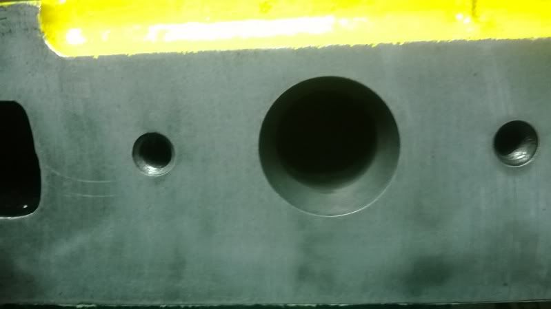

Hi Mr Bounce I've been busy this weekend doing my head too and have found that hydrchloric acid is your friend hereand really gets into the grain of the cast iron.Here are a few before and afters for you.
and after a quick coating of acid
now the piston marks are gone too

Hydrochloric acid - interesting. Not sure I would be able to get that one past Mrs Bounce... :o
think brick acid is the same stuff found in any decent builders yard

Brick acid is the same stuff and if its not strong enough boil it on a camping stove OUTSIDE though works a treat
