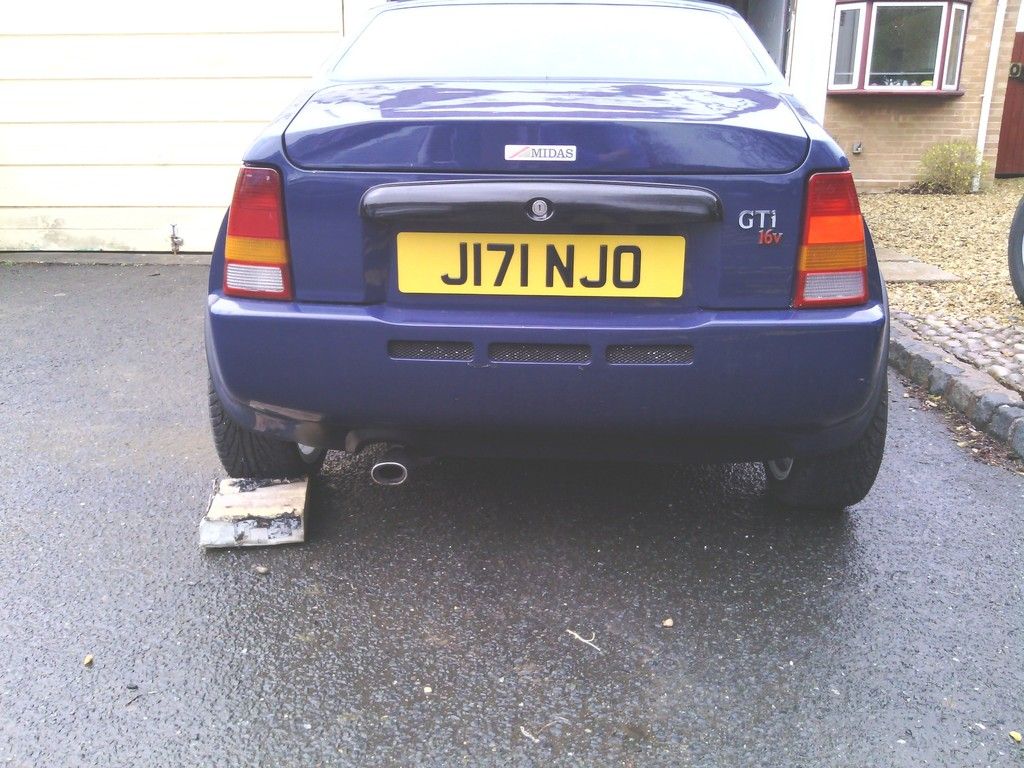

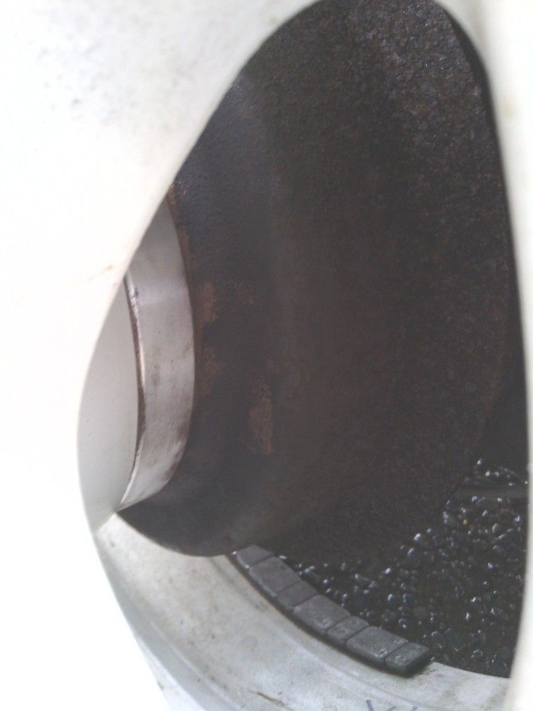

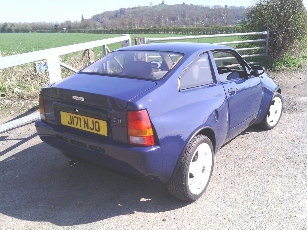

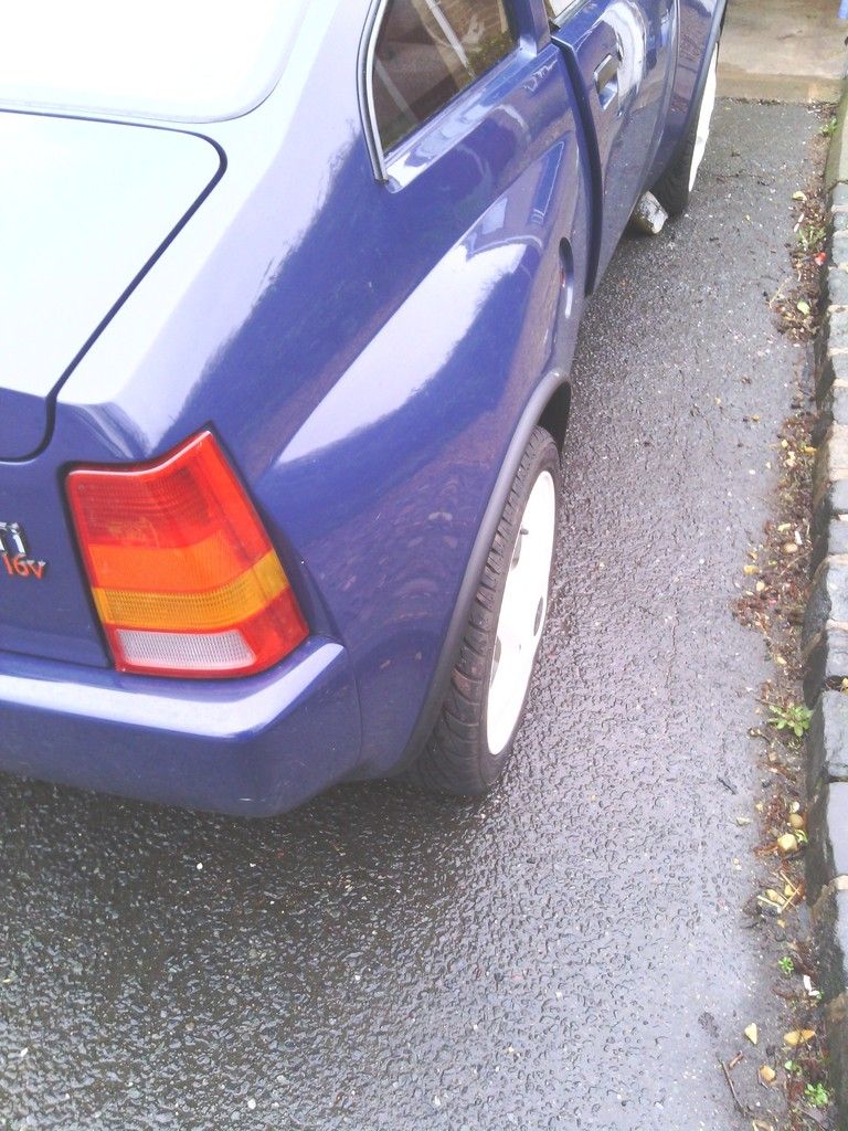

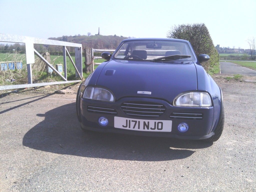

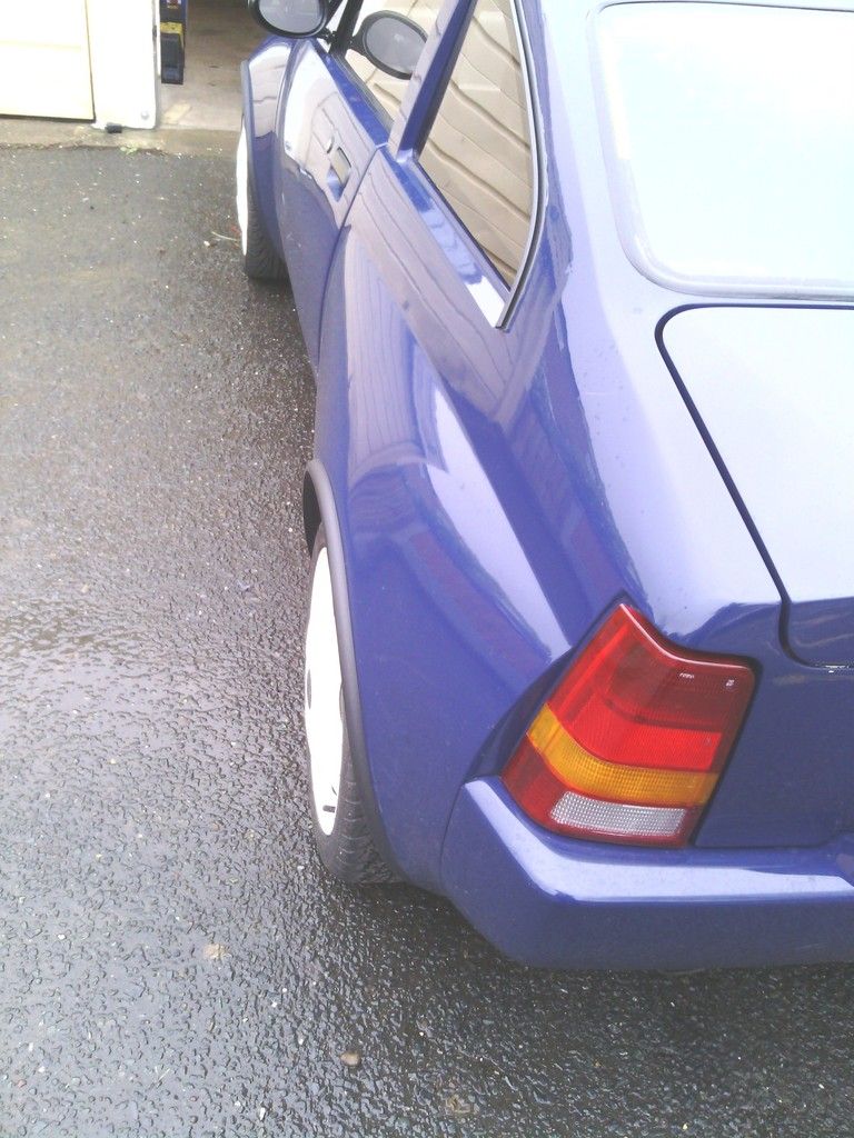

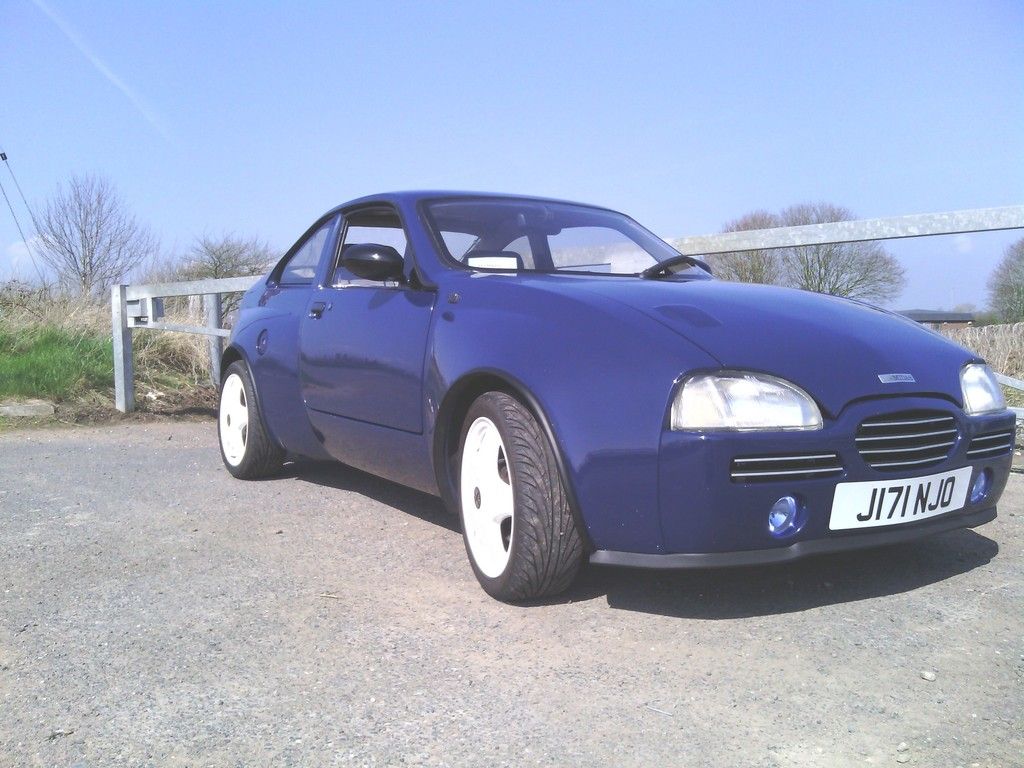

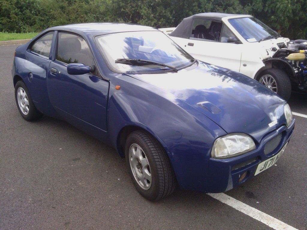

Since fitting the wheel arch extensions it became more apparent just how much wider the front track is compared to the rear, for some reason the front track is 2" wider?
So I measured up for spacers and found 15mm to be ideal to even up the arch to tyre clearance, so bought 16mm - naturally.
Comparison side to side

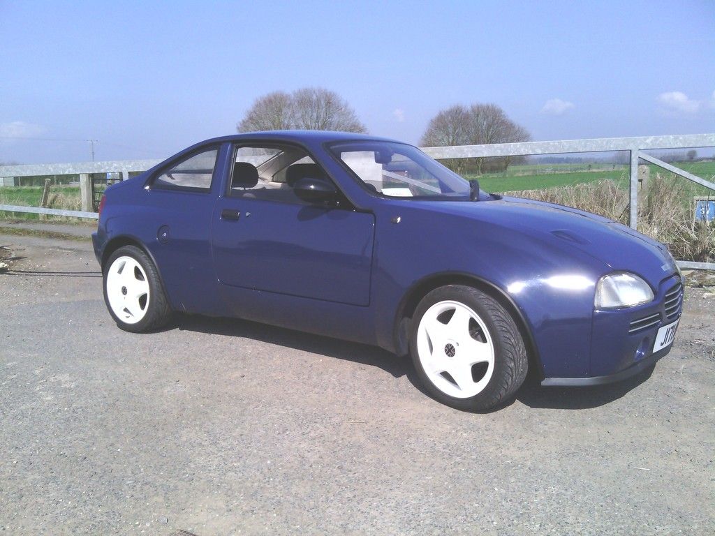

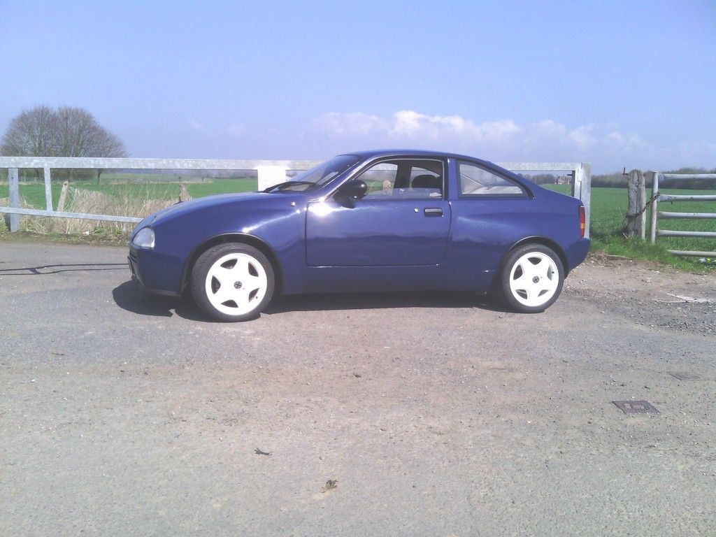

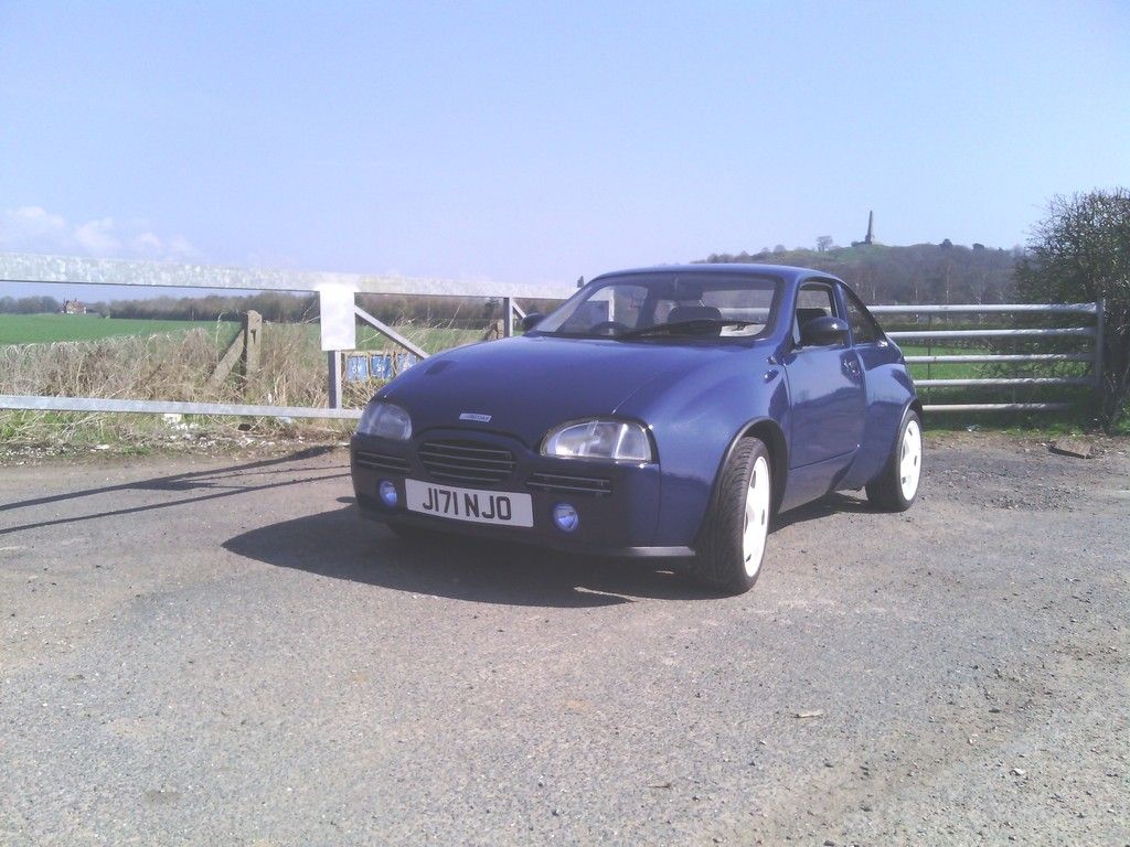

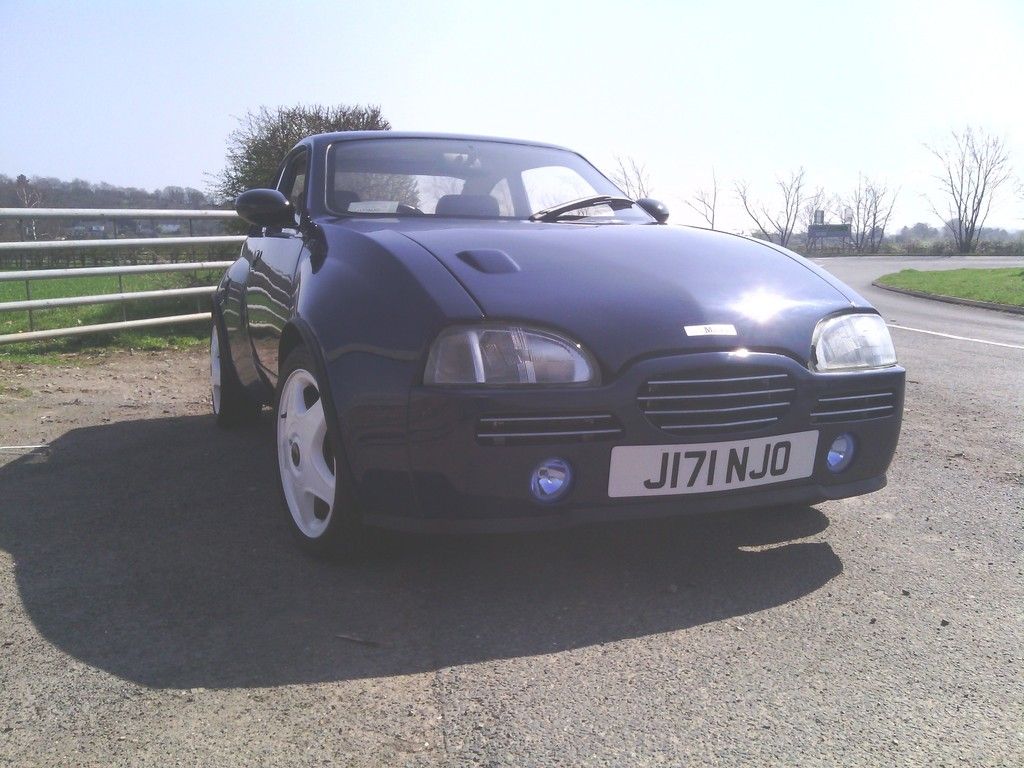

Since the rear now looked much better and the cars inherent skinny arse stance has now been improved I decided to give the front end a new look by utilising a garage door seal on the bumper base as a spolier,,then since the weather was very nice, now seemed to be a good time for some before and after pics especially since I gave it a wash and polish.
Before
After

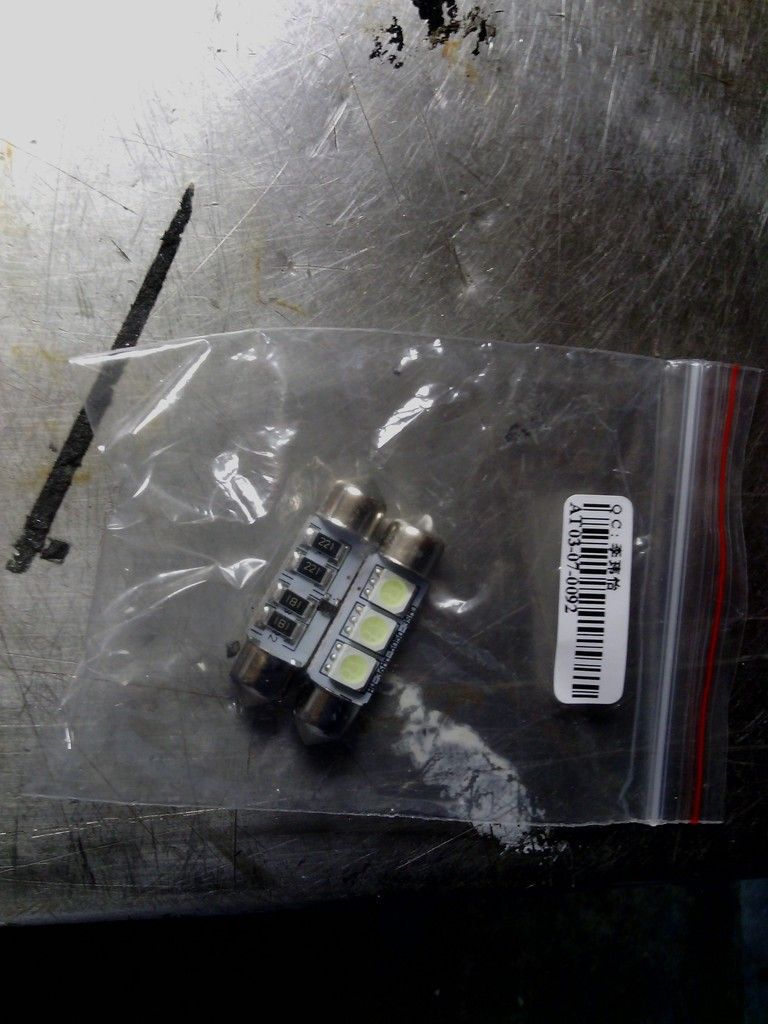

Also decided to upgrade the dim yellow number plate light bulbs for high power LEDs
Best 99p I've ever spent

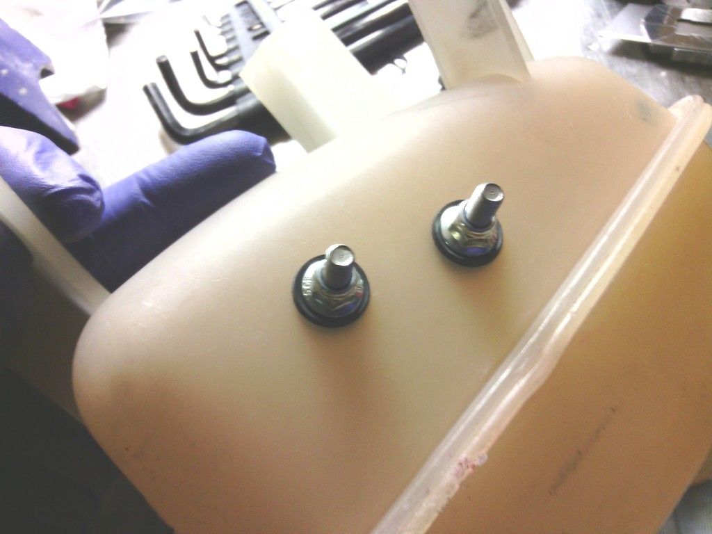

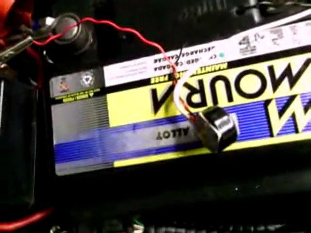

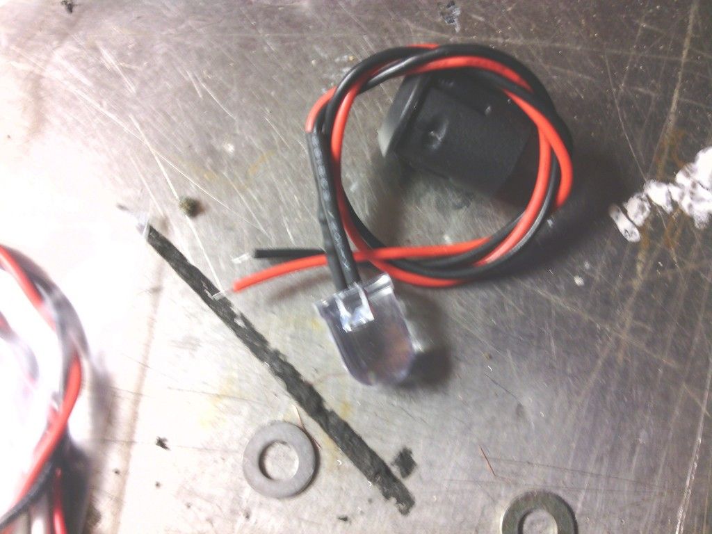

Low coolant alarm
since I’ve heard one or 2 faint rumours that the k series can apparently suffer head gasket failure, I thought it prudent to safeguard total coolant loss and engine cooking, even protecting against a leaking rad or burst hose is a benefit even if the head gasket doesn’t fail.
I made one for my quantum 2+2 sometime ago to give me peace of mind
http://quantumforum.proboards.com/threa ... lant-alarm
And the time has come to do the Midas also
components assembled in the same way, humongous superbright multicolour flashing LED

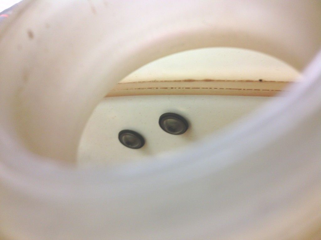

Header tank drilled and 2 stainless bolts sealed in for the probes
One thing I learned from the Quantum is to put the probes at the minimum mark on the header tank and not just below max since it can set the alarm off under cornering - it’s very sensitive.
Testing of the components
this is in reverse obviously but the principal is the same

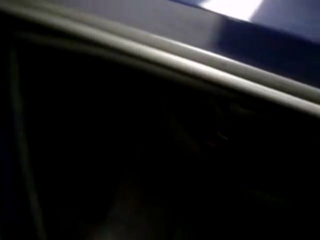

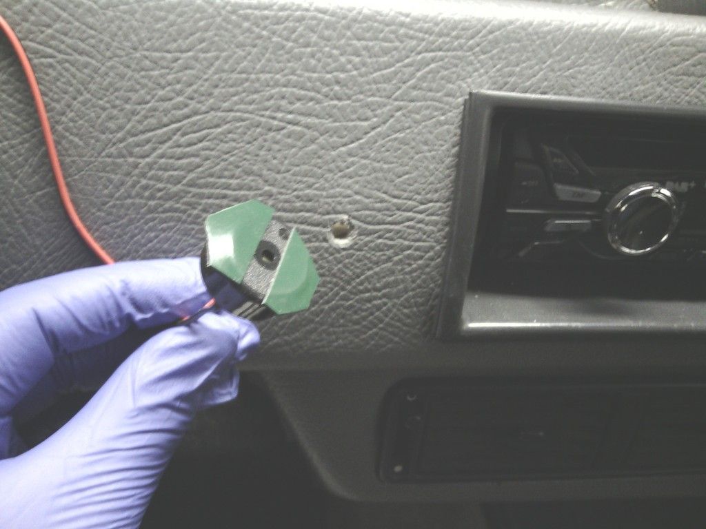

90db piezo buzzer, all wired up

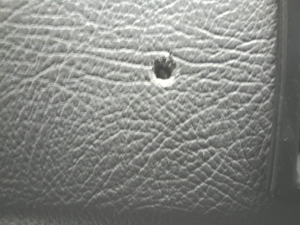

Small hole drilled in the dash front for buzzer to sound, ill fit a bezel to it later
All finished, final functional test

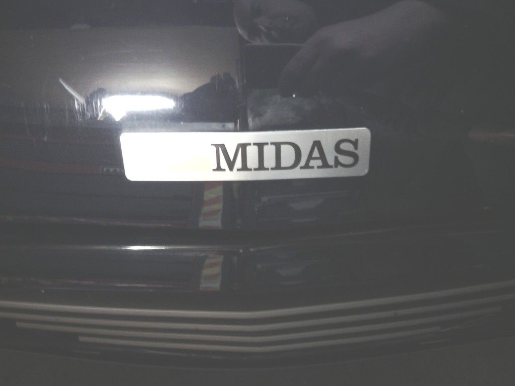

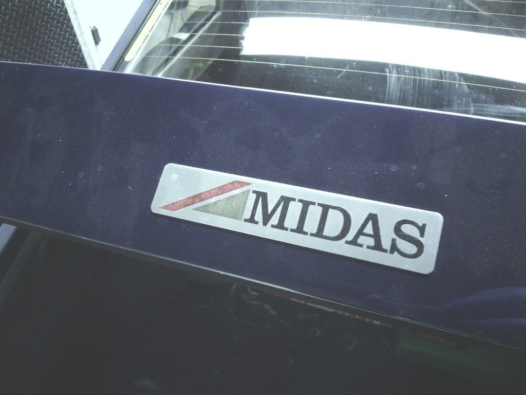

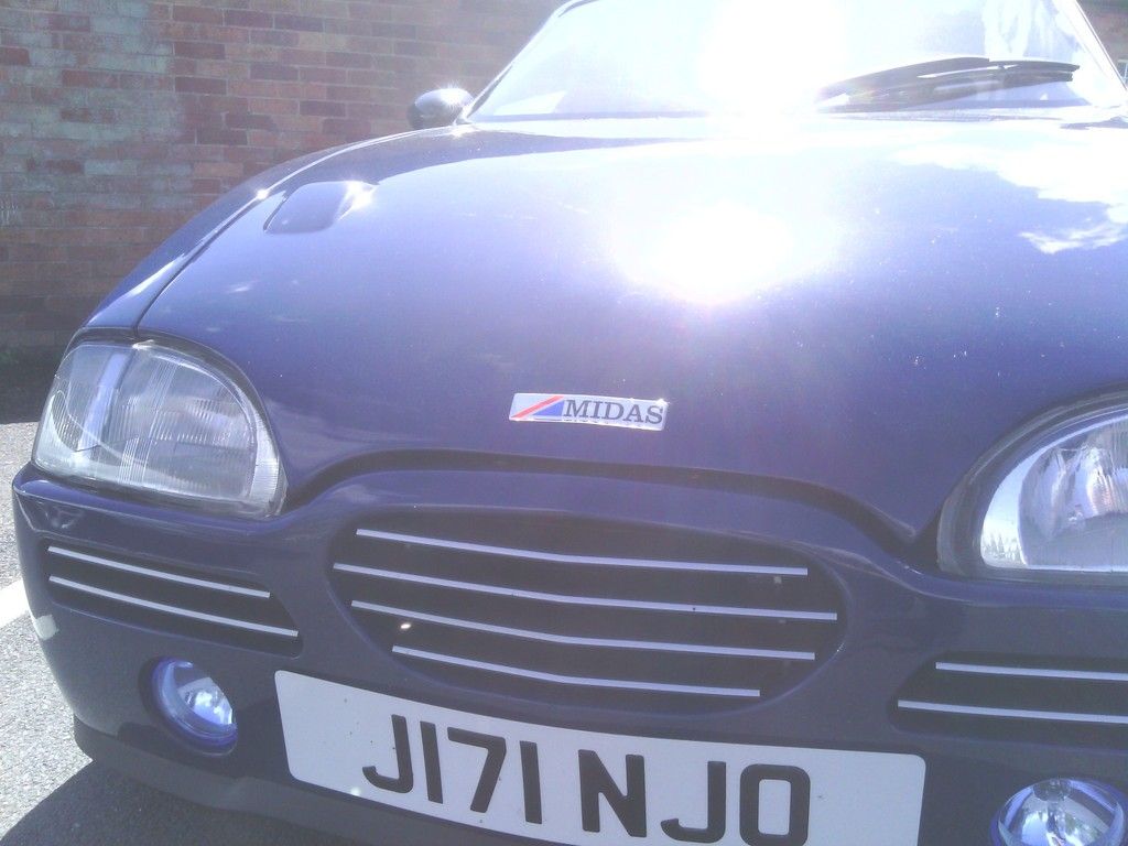

New badgers
The old ones let the car down somewhat so Alistair came to my rescue at stonleigh to provide me some shiny (very) new ones,
Old badgers
New ones
Cos I'm worth it... :D
