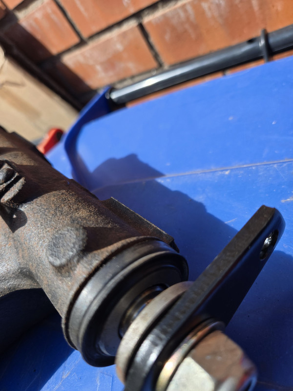

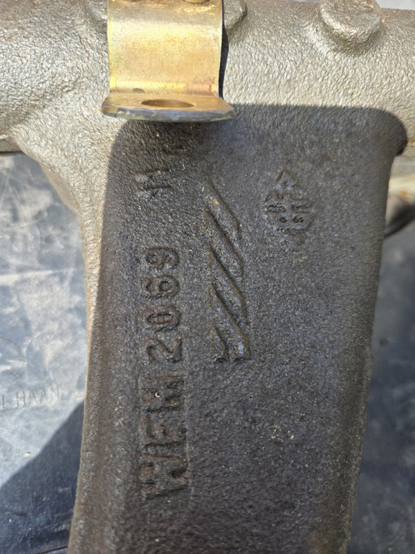

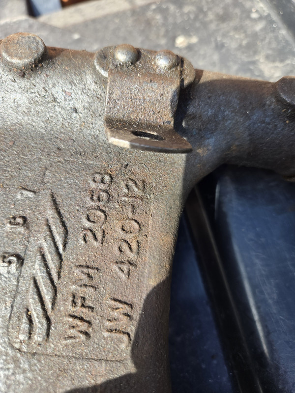

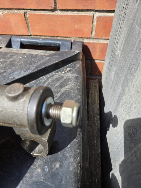

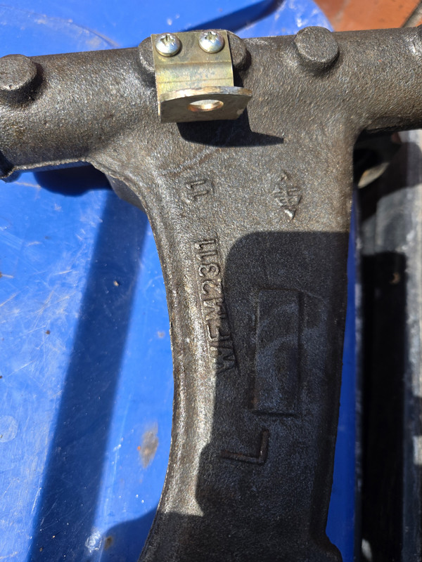

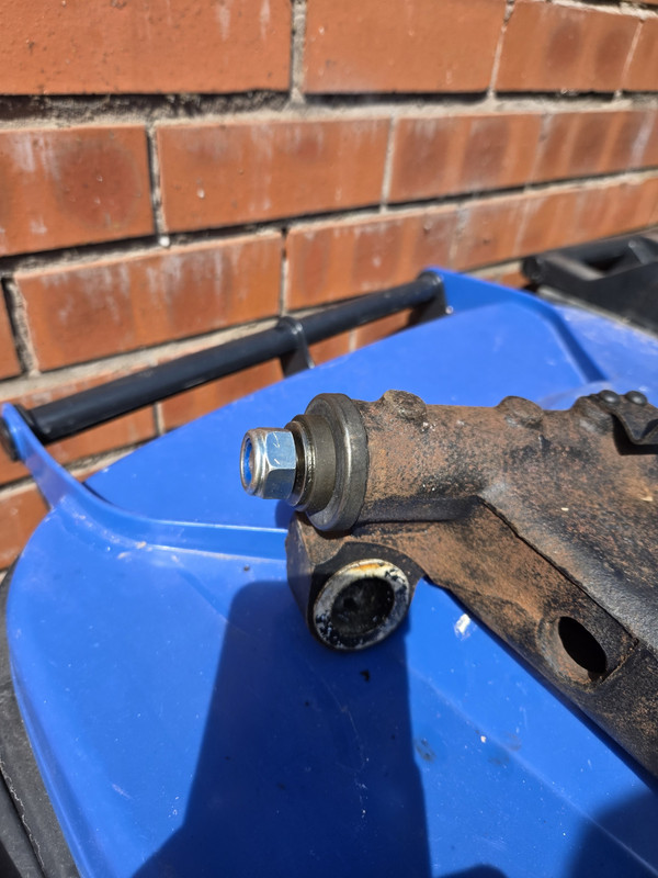

while sourcing bits for a rear subframe assembly I looked at the various types of ever decreasing number of radius arms. Seems that there is a slight subtle difference between the years.
1. Mk1 Metro has solid radius arms and a UNF castle wheel nut on stub axle
2. Mk2 Metros had a hollow radius arm but used same/similar radius arm bushes as Mk1 metros and a UNF castle wheel nut on stub axle
3. Mk3 and possibly Mk4 Metros had a hollow radius arm, slightly sharper casting, slightly different knuckle joint for hydrogas unit and slotted locktab arrangement for the wheel nut (maybe a metric thread too). The radius arm bush arrangement is different. The washers on the end and the thread on the shaft is also different. The diameter of the thrust washer casting shoulder on the radius arms are also different so bear this in mind when fitting the flat rubber rings (dust excluder seal) to hold the grease in.
Different kind of thrust washer/dust extractor seals
