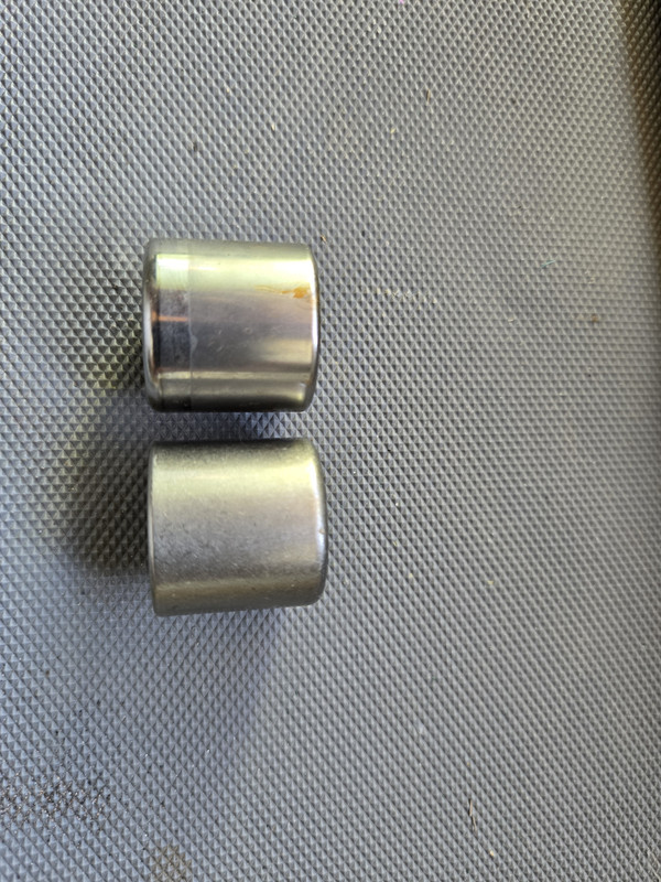

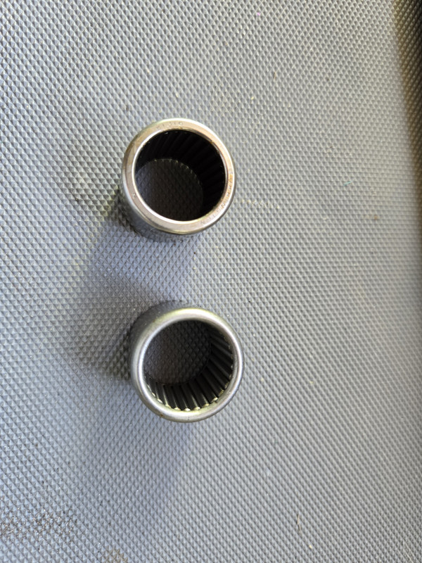

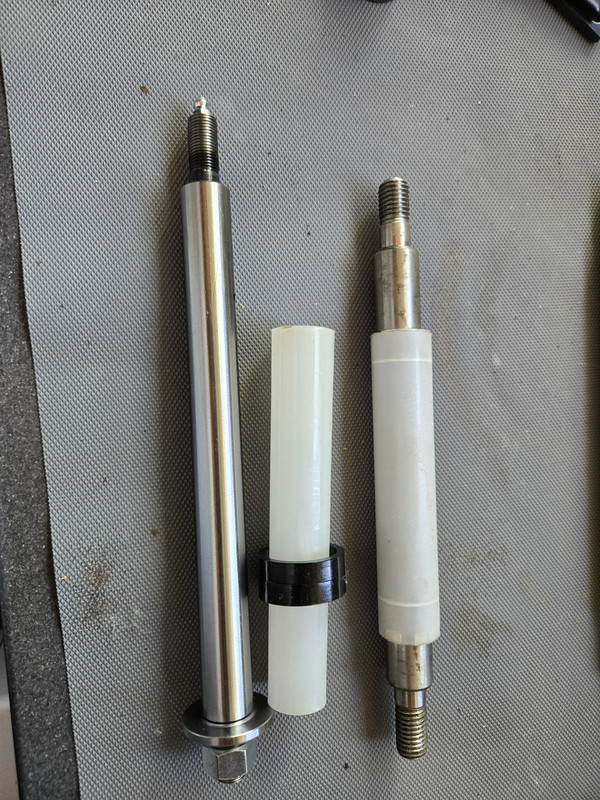

Another comparison for today. :).
I bought a few radius arm repair kits recently. This topic may have already been covered. Sorry if it has. I noticed that the radius arm repair kits for metros are getting rather a bit rarer now on ebay. So bear that in mind if you have a Mk3 or Mk4 Midas.
For interest I bought a mini radius arm repair kit to see what the similarities are. I did this knowing full well that the inner bush on a mini is scintered/ phosphor bronze which has to be reamed - but what I was interested in knowing is what the radius arm dust seals are like and what the outer needle roller bearings are like in comparison to metro ones.
It turns out that the mini needle roller bearings are exactly the same, along with the earlier (see above reference to the dust seals) are the same too. What is different though is the overall length of the radius arm shaft. Its a longer shaft on the mini (which I kind of knew anyway).
The nuts and threads are different too. Useful to know if your radius arm shaft is still in good working order but the needle roller bearings are worn out and your needing to get it back on the road, go for an MOT (if it still applies) or for whatever other reason.
I recon you can use the mini grease tube on the metro shaft too. Its actually longer... which is better at getting the grease to the opposite end which is one of the bug bears of this design. Especially on radius arms which are hollow.....which would need filling up with a lot of grease (a trick mini owners do).

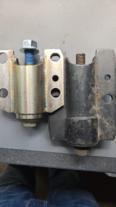

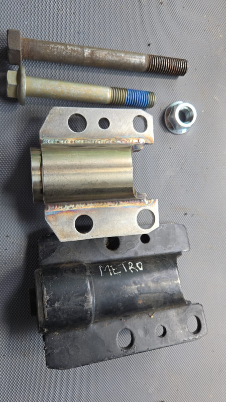

Another comparison. This time regarding metro A series and K series front subframe rear mountings.
I bought a set of stainless ones from a K series to see how they compare to the A series ones. Note the stainless K series one is an aftermarket product but it will be dimensionally correct.
As you may well know, the rubber bushes on these tends to perish after a while and is an MOT failure.
Note the size different between the 2. The A series is the bigger one.
The A series also has a longer bolt and the thread is different to the K series, albeit its the same diameter bolt.
Posts: 1813
Re: Mk3 convertible revisit after 12 years in a garage
Postby manifold » Fri Jun 06, 2025 11:04 am
Another point to note is the fixings positioning.
It is different between the two mounts.
The rear holes align with the positioning hole but the front ones are a few mm closer together.
The difference in overall length is basically the cotton reel shape to the front of the mount on the A series.

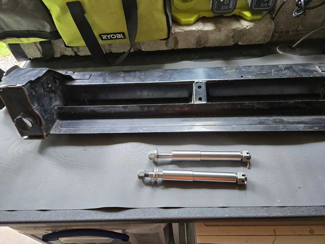

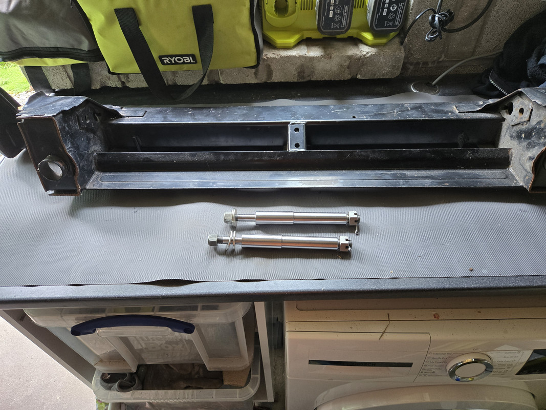

Big thanks to both Victor Craig from Scotland and Alan Donowho from Newcastle for sorting me out a new old stock rear metro subframe and a set of extended rear stub axles. I can now start to put the Convertible back on 4 wheels again in the coming weeks. I must say those extended rear stub axles are a nice piece of machining. Nice radius in the corners. I am well happy.
