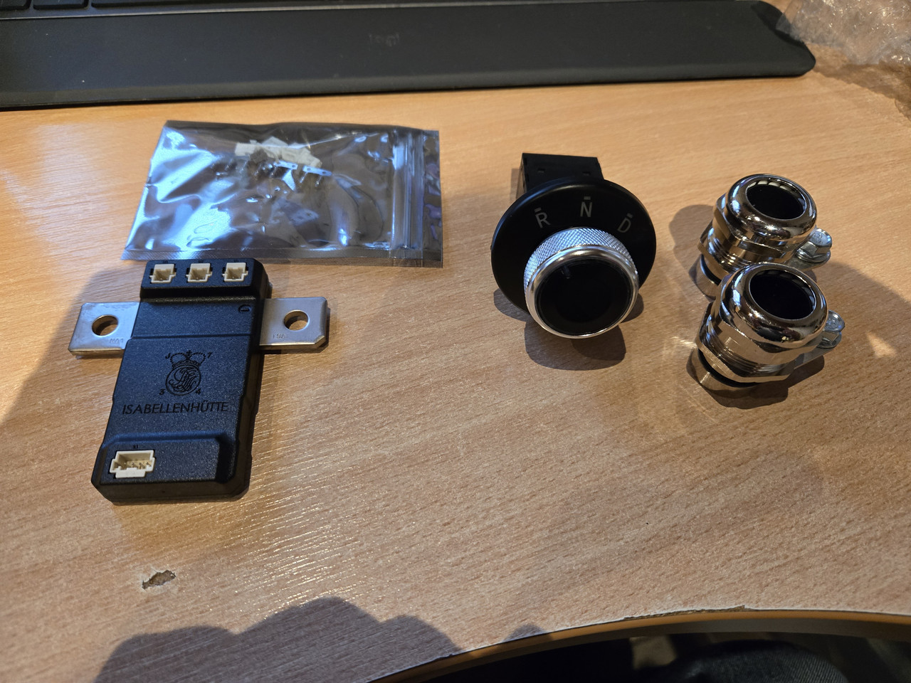

In the mean time Ive been doing a bit more collecting bits for the 'Midlander' Coupe EV. I needed to get an isabellenhutte shunt to measure energy outplut through the battery/inverter which couples nicely with the zombieverter (ended up getting the 500A one rather than the 1000A one, an RND (Reverse/Neutral/Drive) switch and some compression joints for between the inverter and rear outlander transaxle motor unit.

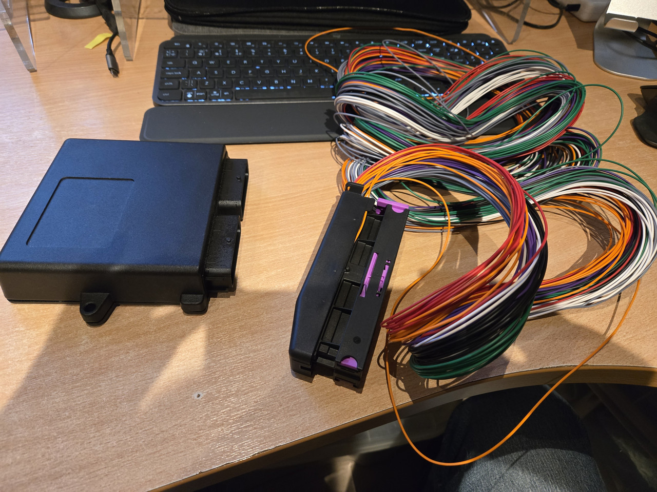

Also recently received the zombieverter Vehicle control unit (VCU) off Damian on the Openinverter forum (https://openinverter.org/forum/) and a wiring loom off aliexpress.
I will be spending some time over Christmas getting to know the zombieinverter which can be accessed via a local webserver it presents via esp32 type chip with built in wifi and bluetooth.
First thing to do is fire it up, update the firmware then think about wiring in the dual channel throttle pedal. The reason for dual channels on the throttle is for redundancy. First off I bought a VAG circa 2014 SEAT pedal as a test. Not sure if this one will do but will give it a whirl. Reason for choosing this one is because it was quite small. Which will be a requirement in the Midas footwell. Apparently they are pretty standard across the VAG group of pedals but will soon find out. Otherwise I might be looking at prius or leaf pedals.
