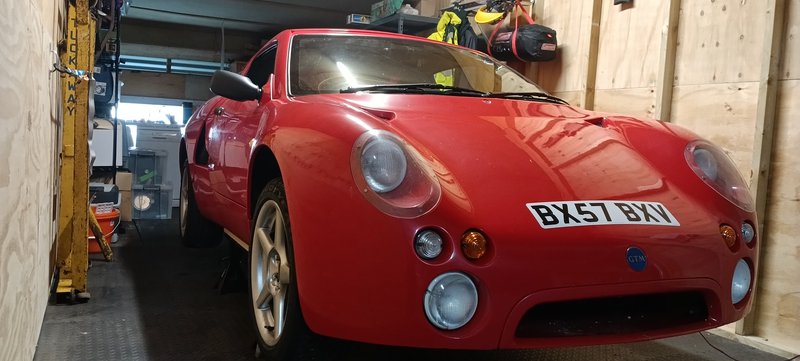

The Midas is still in bits, but there's a sort of plan for that one, the Libra I've rescued from the non-too dry storage and moved it to a larger and drier unit near where I am living now. Last week I hired a transporter, pulled it out of one and put it into the other.

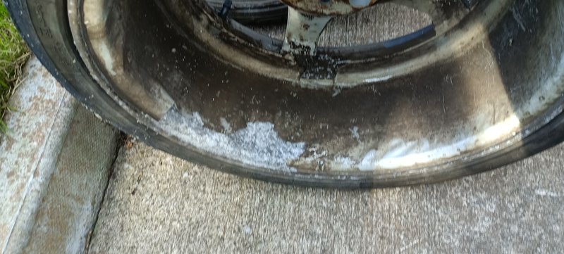

So the car is in the unit and lifted up onto stands. While it has been stood a lot of the powder coat on the wheels has failed and now only one tyre will stay inflated, the throttle cable was a bit sticky when it went away and is now completely solid, which made getting it on the transporter a bit entertaining. It did however start first turn of the key with fresh fuel and battery.

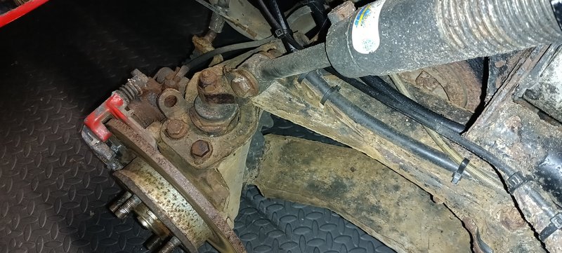

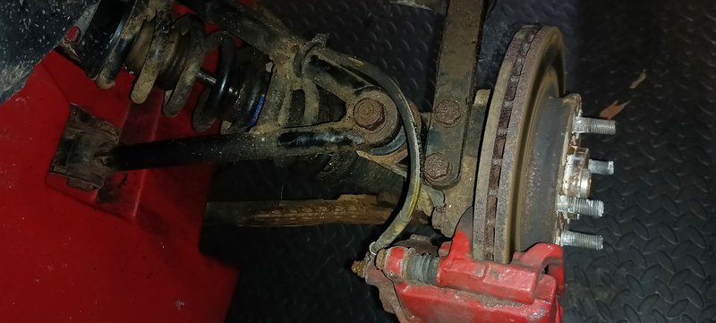

There is a similar story on the suspension where the powder coat has failed completely.

Strip and recoat suspension
Replace brake discs and pads, rebuild calipers where needed.

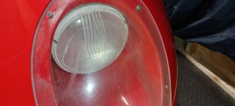

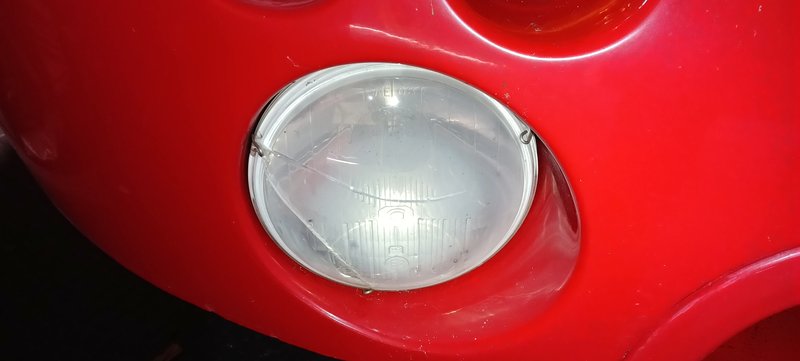

Repair or replace broken/fogged headlights (see below)
All the lights are 5 3/4" Cibies, I'm hoping I can sort out the fogging, the broken one is obviously scrap.

New light units on order to replace the broken Cibie, all of them have fogged up, but hopefully have saved the main headlight units with careful cleaning. The GTM Libra uses four of the same Morette unit holders as the Midas Gold, whoever thought that fitting them with mild steel adjusters was a good idea needs to have a word with themselves. All fittings have now been removed with varying degrees of brutality and replaced with stainless parts and new nylon adjusters.
