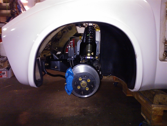

Postby Mininut1 » Mon Aug 11, 2014 11:48 am
Front brakes fully rebuilt
Mininut1
Posts: 17
Joined: Thu Aug 02, 2012 11:40 am
Re: Midas in New Zealand
Postby Mininut1 » Mon Aug 11, 2014 11:50 am
Front 4 pot calipers
Mininut1
