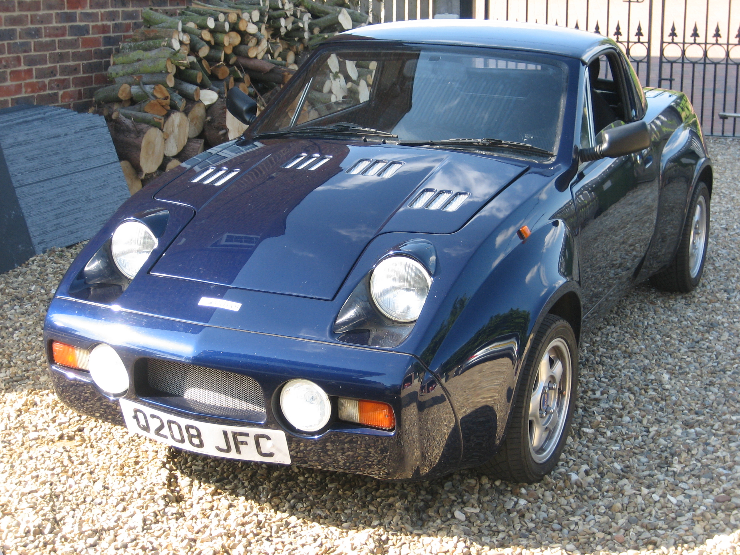

Here she is …..
Just got to get her going again.

Postby Hans Efde » Wed May 30, 2018 9:25 pm
Awesome buy, what an amazing color. Shouldn't be too difficult to get her going again. Alistair did a writeup on this forum how to revive a car that has been garaged for a few years.

Postby Crowmann » Thu May 31, 2018 6:31 am
Thanks Hans.
It is a good build with lots of nice detailing - especially under the bonnet and below.
The seller beleives the head gasket has gone between two cylinders - so getting her going might be very simple. Or not.
The improvement areas are just detailing the dash and small areas of the cabin.
