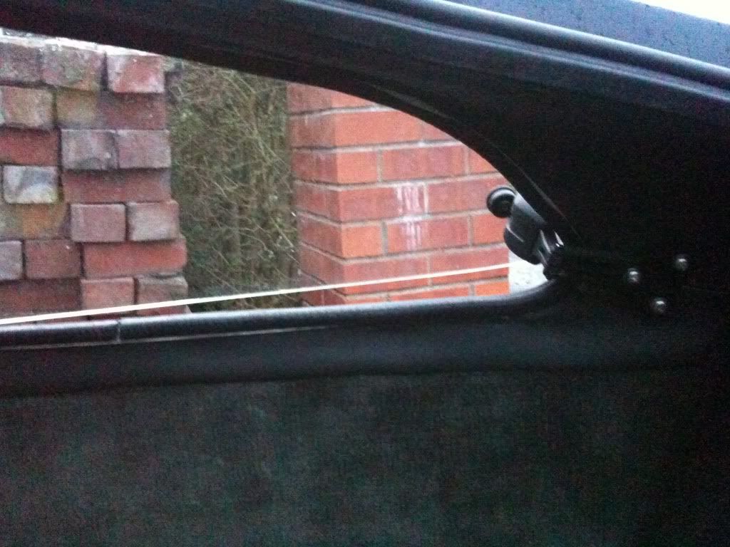

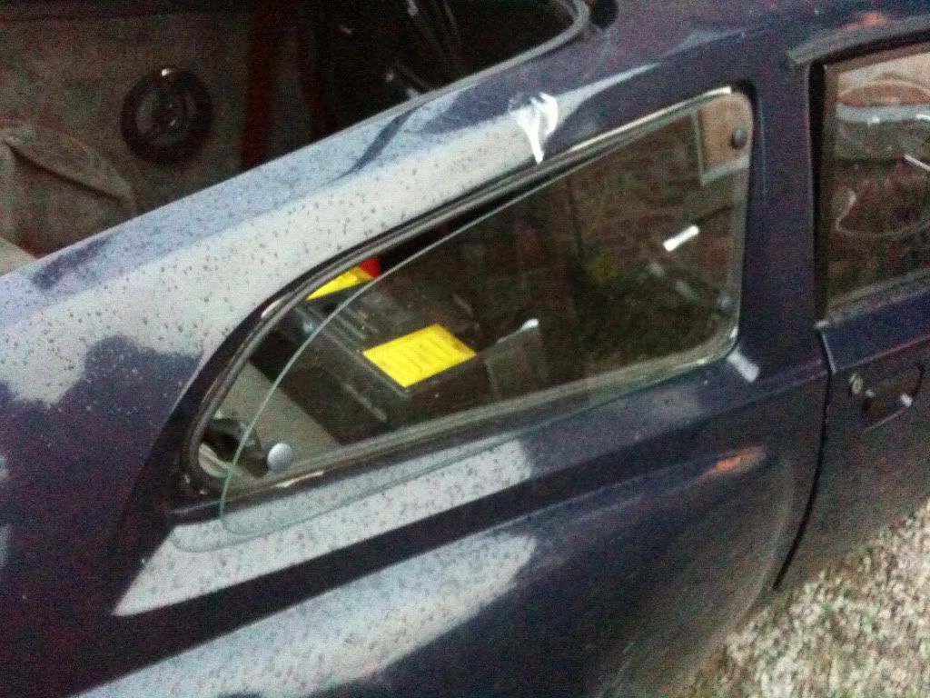

Re: Heated front Windscreen project for Mk 1, 2 & 3 (Group B
Postby manifold » Tue Mar 29, 2011 7:43 pm
Window opener. hinge, showing an original and one I cut down and redrilled.
Perspex glass template. Note the drilled holes (x3) to suit the window holder buttons.
Window in open position
Hinges fixed in. Only 1 screw each, as per original use.
Window opener in position. You can adjust the closed position of the glass (ie how much it presses against the rubber) by shimming the back of the triangular base with washers.
Posts: 1813

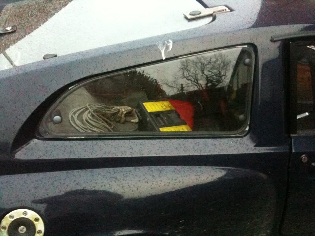

Postby manifold » Tue Mar 29, 2011 7:59 pm
Here you go Stuart.
Ignore the rain spots, the birdshit and the masking tape under the rubber (to stop the trim pulling back)
Posts: 1813
