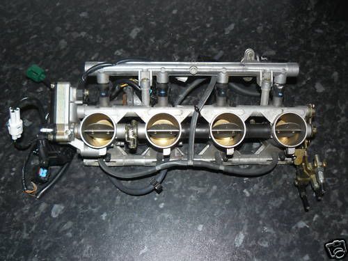

Postby manifold » Thu Dec 10, 2009 9:47 pm
onwards and upwards.......
time for some EFI.
In the form of a set of suzuki gsxr600 (bike) TBA's and megasquirt. Linking it in with the EDIS based Megajolt I already have.
These bodies are great as you can get them for only a few quid, modify them by splitting them to suit the openings on my weber DCOE manifold and plumb it in (with some other bits. Set the megasquirt to self learn and away you go.
Like this on a Ford motor.
http://www.sportingfords.com/forums/viewtopic.php?f=16&p=19574#p19574
You can use the same idea, but using just one TBA on an A series manifold. Not for outright power, but nice for something a bit different plus nice driveability.

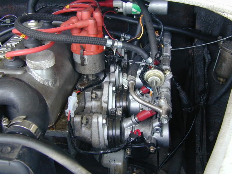

Postby Geoff Butcher » Fri Dec 11, 2009 9:12 pm
I've got a set of Suzuki GSXR750 throttle bodies on my Alpine. Took it to be re-mapped a couple of weeks ago, and got 123bhp, compared with just over 100 on the previous sawn-in-half 40DCOEs.
Re: Something I have been working on.....
Postby Geoff Butcher » Fri Dec 11, 2009 9:38 pm
And this is what they look like...
Postby manifold » Fri Dec 11, 2009 10:00 pm
nice one. when you think thats a 25% increase in power. where did you get those manifold stubs from to connect the TBA's to the dcoe manifold?
Posts: 1813
Postby Geoff Butcher » Sat Dec 12, 2009 9:02 pm
They're home made.
Actually the last 3bhp don't really count, as they were due to temporarily attaching some trumpets, which I can't use with my air box in place.
