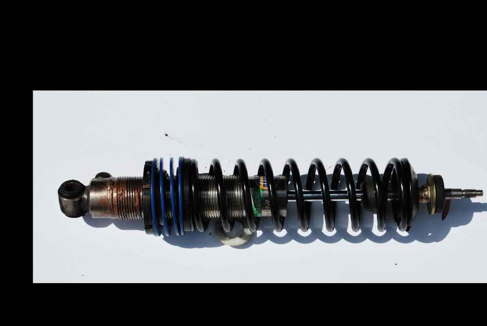

Postby Stuart » Thu May 26, 2016 4:45 pm
Here's a photo of the currently supplied Midas spec GAZ damper next to a shortened AVO one.
Here's an option with perhaps a run-flat spring of just 4lb/in

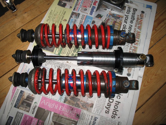

Postby MrBounce » Sat Jun 25, 2016 7:55 pm
Chad re the rear shocks I would definitely recommend contacting GAZ - I sent them an email and they put me in touch with their tech department. They will ask for various info - see below
1 Intermal dia of the spring 1.9” ?
2 free length of the spring (uncompressed )
3 IS THE DAMPER LENGTH MEASURED CENTRE OF END FITTING TO CENTRE OF END FITTING ?
4 Bolt size of bottom bush ( 3/8” ) ?
5 Width of lower bush inner sleeve
6 Pic of top mount rubbers .(there are 2 types )
But once given all their appropriate info they came up with these beauties a few weeks later - and they were cheaper than expected. Just got to build the car now... :lol:

Postby ACourtney » Mon Jun 27, 2016 4:45 pm
I normally recommend GAZ for rear dampers and suggest talking to Dave at Dampertech, rather than GAZ direct. Dave has been supplying Midas cars with dampers and springs since the year dot and is a mine of knowledge.
The only weakness with the GAZ damper is that the plating on the screw thread is rather thin and can start to develop rust spots. I've discussed this with Dave and GAZ, but they say that they cannot make the plating thicker and ensure the clearances on the screw thread. I now spray the screw thread area with a protection wax (e.g. waxoyl) once I have set the ride height.
