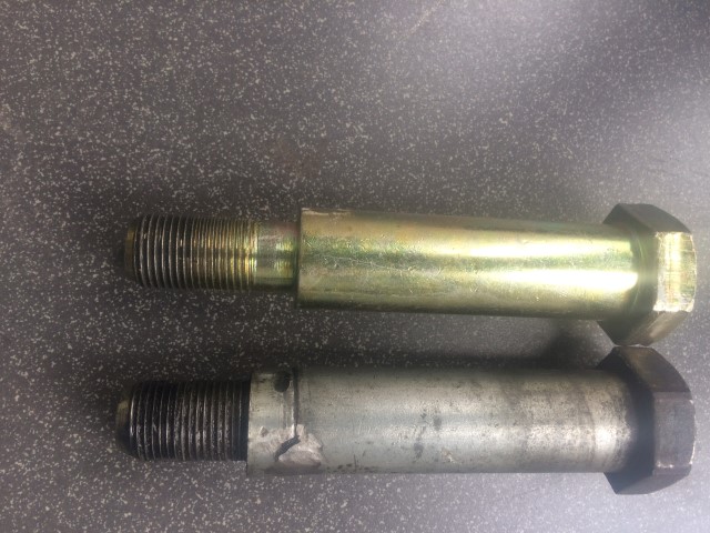

The big bolts which are coming from my Midas MKII shows a adaption ( they have put a ring +- 10 mm over the original bolt ) ,is that a normal solution by the MKII and the reason ?

yes spacer is required because of the extra thickness of the grp, the grp doesn't look worn to me.

Concerning spacer : ok I understand , tahnks !

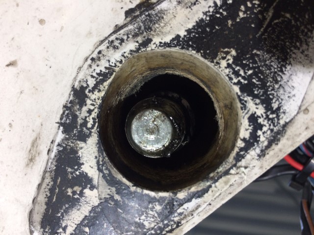

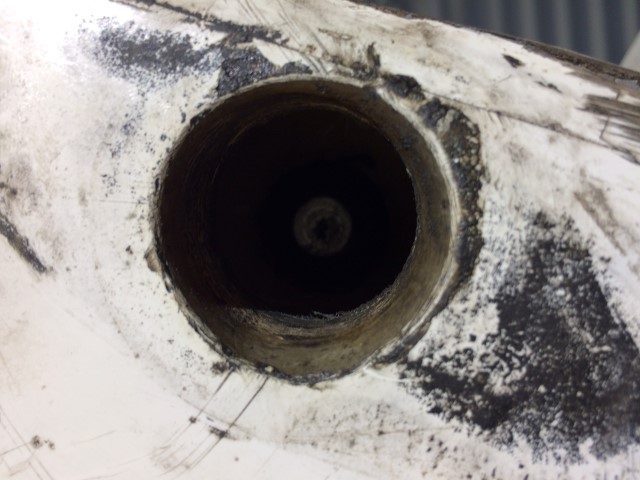

Concerning the holes : do you think that the holes are not worn .....I would say that the holes aren't 100% cilindrical but maybe that's normal or maybe the degree of worn is into the limits ?
But in case I repair this , how would you repair such a problem ?
What hole diameter would be correct to assure a tight connection ?

Postby Stuart » Fri Sep 14, 2018 4:32 pm
I find the wear is on the horizontal surfaces where the rubber bush abrades/rubs the gelcoat away, more so on the top surface.

Postby ilmung » Fri Sep 14, 2018 4:38 pm
Yes that's right , the worn is situated +- 3 to 4 mm max. deep in the hole , the rest is 100% cilindrical.
Can I do a grp repair or use a special product to correct the hole ? ?

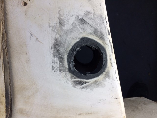

I have taken another method to rectify the used towerholes ,notwithstanding i think that my idea to make rubber sleeves around the towerbolts should be a better solution.
This morning I have put some Loctite 3478 which is a epoxy adhesive metal ( expensive :o )which become very hard, on the used places of the towerholes.
Once the resine is complety hard , I bring the holes to the right diameter again ,with a metal reamer .
