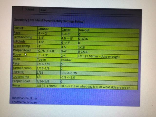

Postby ilmung » Tue Oct 13, 2020 8:55 pm
Does anyone know the "best" settings for camber/caster/toe for a fast road MKII .
I have dry suspension ( standard rubber cones ) and 12 " wheels 165/60/R12

Postby ilmung » Fri Dec 18, 2020 11:59 am
This are values for the mini.
