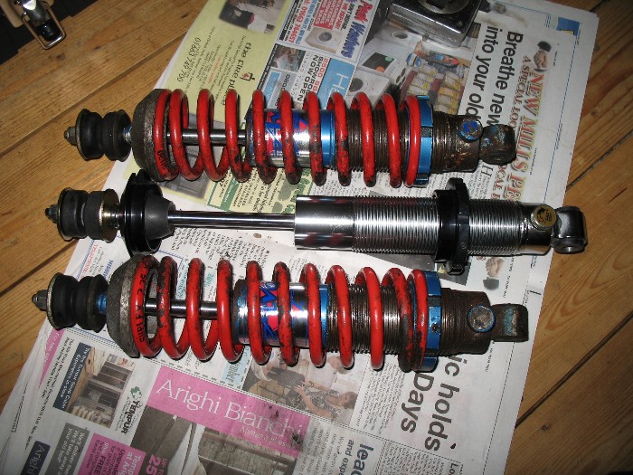

On the my Mk 3 the coil-over set up consist of a standard 13 inch Gaz adjustable coil-over, a 40 pound per inch helper spring and a standard spring (spring rate to be discussed). These two springs are joined together with a special spring seat platform. Yes that’s right I have two different rate springs on the one coil-over, which is a suggestion from Stuart which I would take up and explore further.
See picture 1 to view the unassembled component
The blue spring is the helper spring, the black ring is the spring platform and the black spring is the main spring. The C shaped item on the right of the picture is the locking ring, which holds the whole assembly together.

Show picture 2: fully assembled coilover

Here's some of my shortened AVO's next to a standard length GAZ. I've not actually driven on the GAZ dampers so can't really comment. I know Alan hasn't had much success with getting a nice ride with his GAZ set-up and they've gone rusty despite the zinc finish.
