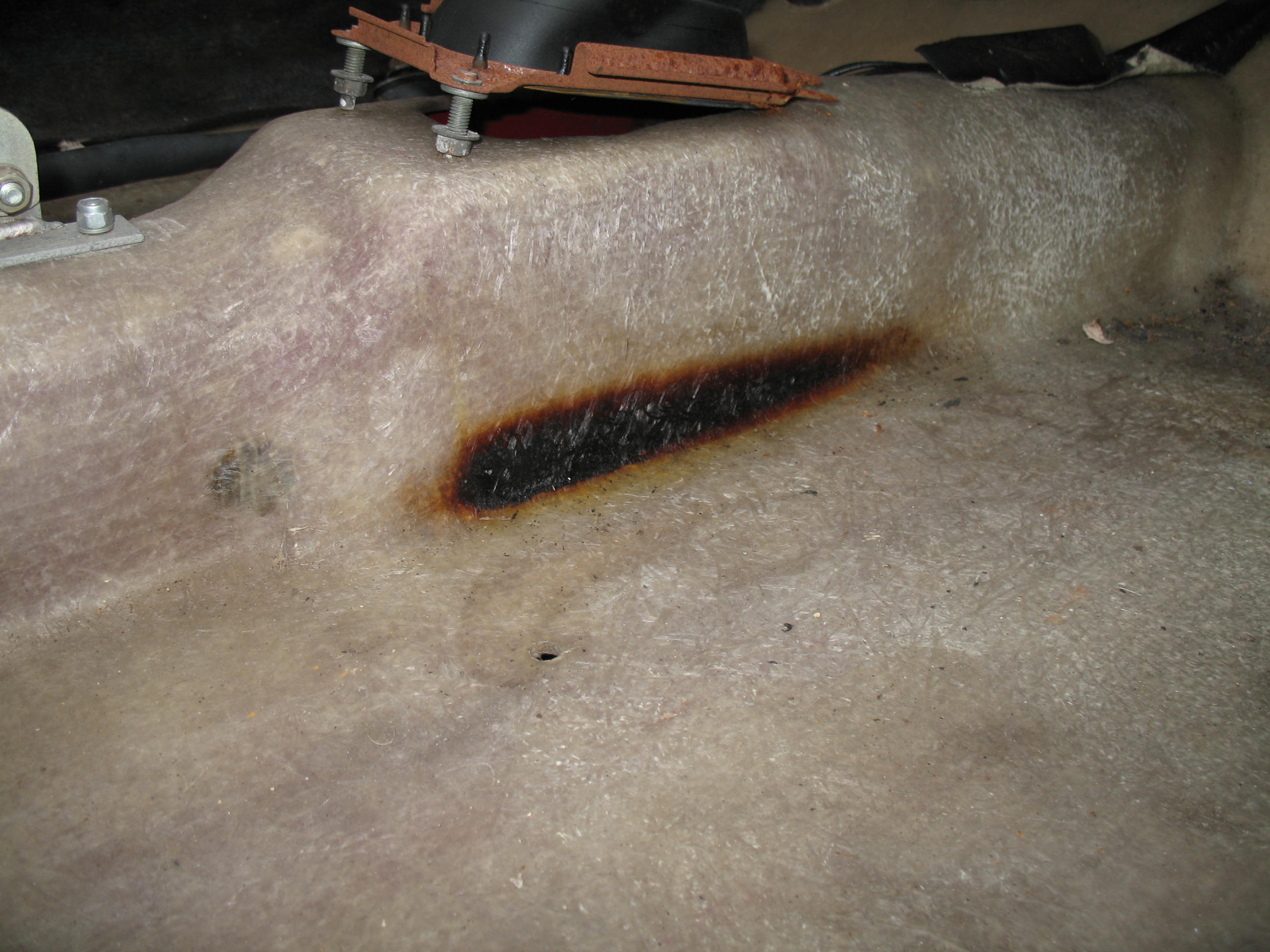

The closeness of the exhaust to the GRP tunel prompted me to fit an aluminium heat shield (Demon Tweeks) and also a new hanger forward of the gearshift as the clamp on the downpipes was failing to hold things level. Top braket and loop are Mini Spares, botton hanger is Halfords. Image

Yes they can burn right through if you're not careful :o
