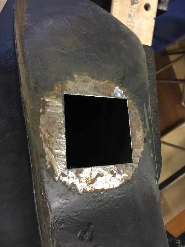

I got my old tank back from Pro-Alloy and have decided to have a go at fixing it myself !!

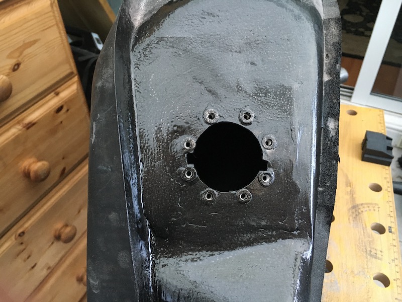

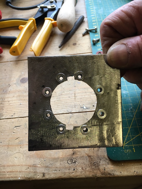

To that end, I have chopped out the old Sender unit mounting and made a new one, which my mate welded in for me.
Next, I am going to do a leak test and am hopeful that all will be well because the amount of mounting screws (instead of the old locking ring) should be enough to hold it all together (see photo).
I will keep you posted!
replacement sender unit mounting
old sender unit mount removed

Postby axshack » Thu Nov 28, 2019 12:23 am
new sender mounting welded and painted .....

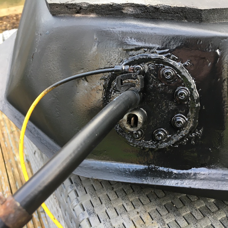

Postby axshack » Thu Nov 28, 2019 4:16 pm
Final photo of repaired fuel sender unit mounting....still wet from paint. Looks a bit messy due to the thick cork gasket, but so long as it is functional, who cares?
Leak check: OK
Electrical continuity: OK
Going back on the car tomorrow !! :P
