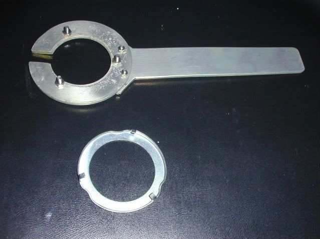

Some time ago I bought a fuel tank sender off fleabay. I've just noticed it only has one connector, whereas the one on the car has two. Has this been modified to allow for the Midas tank not being grounded, or have I bought a dud? Also, how do you undo/do up the locking ring without bending off those stupid little lugs? What a crappy design!

I knew you'd want to see my three-pronged widget, locking rings for the turning of.
I must have too much time on my hands...

nice looking tool!
