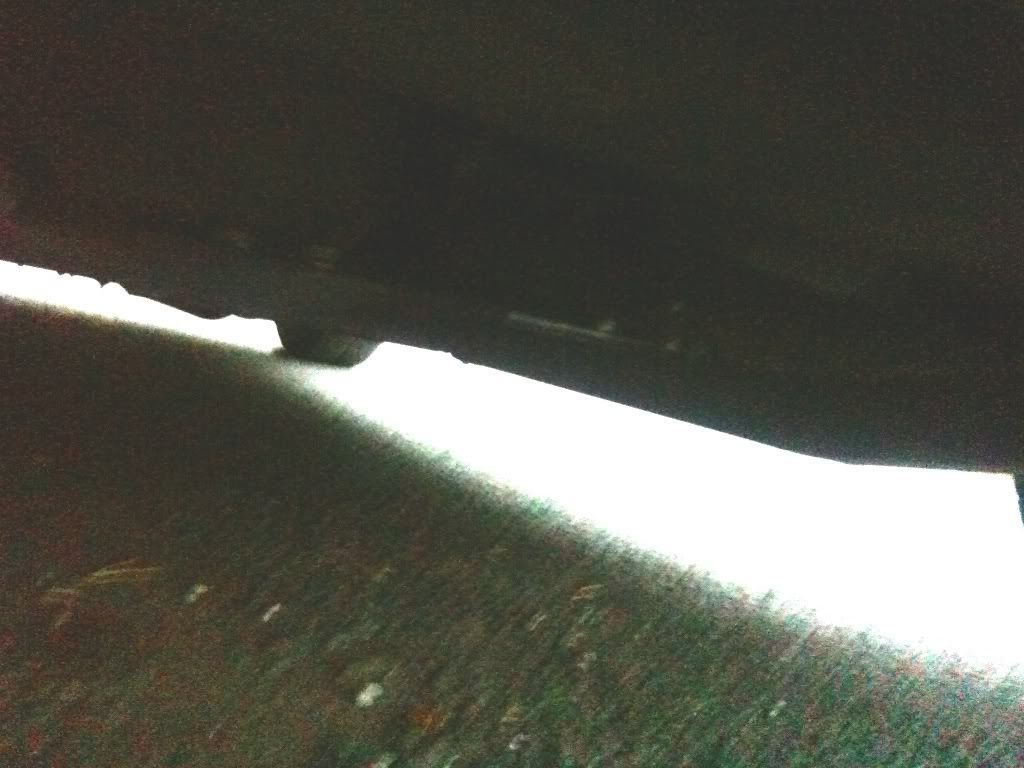

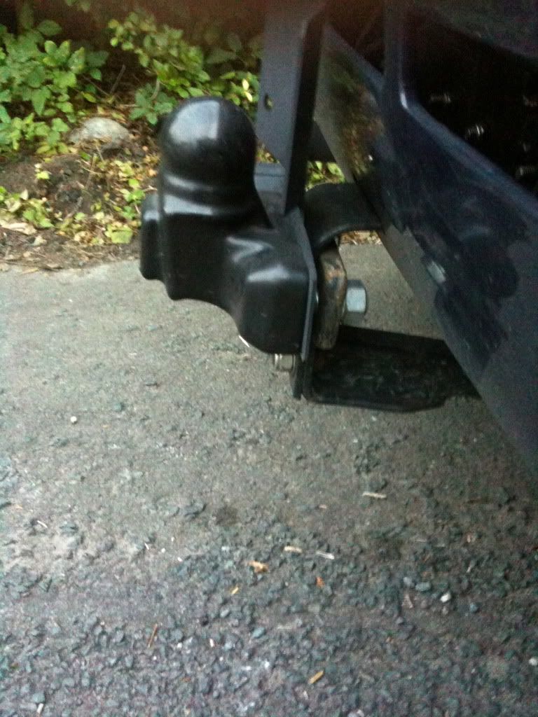

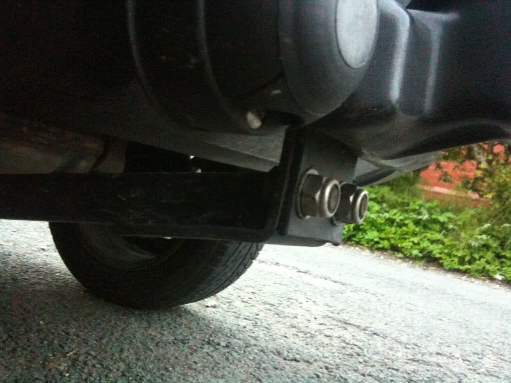

Like I said earlier, I was told it was a 'factory' one but the quality of build makes me doubt it. The actual design itself is fine though. I am always using the tow hitch. Great for moving tall ladders about on a trailer.
Looking at the photos I'd also doubt that it was a factory made item; it looks to me like it blocks off the three vents in the back panel. I can't see the factory doing it that way - as I understood it, those vents were to allow air to flow around and past the silencer. However, that could be a load of rubbish and they might just be "styling" vents.

Postby manifold » Fri Sep 02, 2011 9:24 pm
It doesn't block the back ports off.
However I do have a 'special' factory bumper which has 'hidden' vents under the rear lights to release the air pressure.
Not seen any others like them, although there must be.

manifold wrote:It doesn't block the back ports off.
My mistake, must be the way I was interpreting the photos.
However, do the "hidden" vents appear under the middle section of the rear light units? Mine has what look like vents there, they're about 2.5" - 3" wide and just big enough to get my four fingers in.

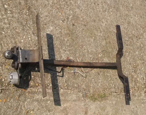

manifold wrote:my boat goes up a slipway no probs.
Heres all the pics I have.
David,
I'm about to start building my towbar, but before I do; do you know (or can you measure!) the thickness of the steel used to make yours?
Thanks. :)
Re: Towbar
Postby manifold » Tue Jul 17, 2012 10:03 am
Its generally about 4-5mm angle Iron and box section.

Postby DavidL » Tue Jul 17, 2012 11:04 pm
manifold wrote:Its generally about 4-5mm angle Iron and box section.
Thanks, David. :)
