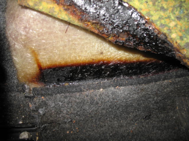

Postby Stuart » Tue Apr 29, 2014 10:38 am
As Hans has shown original squeezes between the tunnel wall and gear-selector housing, which is good for ground clearance, there is a section of the tube that passes directly past the gear-selector housing with a flat section squeezed into the tube, however it is still a very tight fit, and has a habit of doing this to the central tunnel :o

Postby stevew » Tue Apr 29, 2014 8:32 pm
What a quick and fantastic responce, many thanks to all. The photos certainly give plenty of food for thought. Has anyone tried raising the selector unit? Having a look at it again and wonder about maybe enlarging the hole in the tunnel bending the rods suitably. Any thoughts or things to watch out for?
