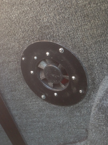

Hi all,
I just discovered that what I thought was a pair of Pioneer speakers in the rear of the car are actually extractor fans !!
Is this a standard modification or even a factory option? I could not find any mention in the build manual so I assume a mod by the previous owner.
Next question, if anyone has come across this before, how are they powered? I am unable to find a switch for them, then I thought maybe they are activated when the heater blower is on, which makes sense I guess. What do you think?
I am a little in the dark on this one as the original builder isnt answering the phone, so any help will be gratefully received !!
Cheers
Dave
extractor fan - not speaker ! good idea, but how is it controlled I wonder?
Re: Extractor fans
Postby axshack » Sat Dec 06, 2014 12:47 pm
what I forgot to say is that when the heater blower is on, these fans do not work !! So before I strip it all down to chase the circuit I thought I would ask the question of the experts !! Thanks

having taken the dash apart today, I now know how they work...well how they will work when I connect them up.
I think I will run them at the same time as the heater blower. They appear to be PC case fans so will not draw much current, but will take them out to check the rating just in case !

I will wire them so they pull and act as extractor fans. This should help keep condensation down !!

Just heard back from the builder and original owner, he thinks he connected them to the heater blower, so that was a good guess !
