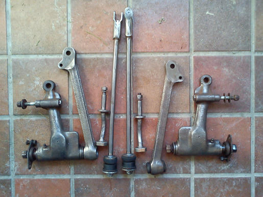

Hmmm I guess I'm too impatient as I left my front suspension components soaking for about 60 hours and gave up. Most of the work was done with a wire brush on a grinder in about 20 minutes. Perhaps I might try some small parts again sometime but really I'd recommend a wire brush over Vinegar.
Here's the results I got which I'm pleased with and will paint them shortly.

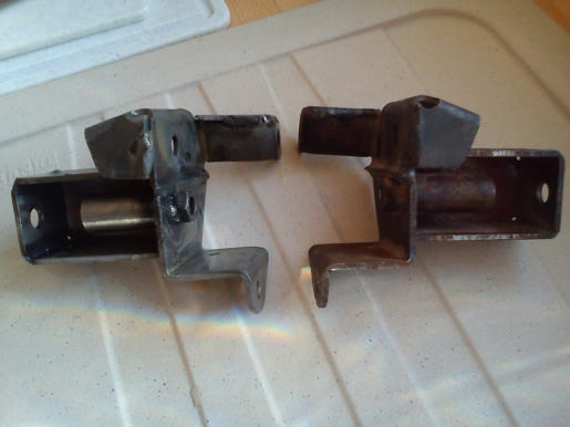

OK I found a non corrosive cheap alternative to vinegar :)
Molases. Yep just dilute some molasses 9 parts water to 1 part molasses and dunk your steelwork in it. Here's what I got after an over night soak with a pair of brackets for the Midas. The one on the left is the result of being left in a bucket of molasses overnight, on the right is the untreated bracket.
Not bad eh? It also worked freeing up a corroded nut and bolt.
