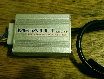

This time around I have a second hand unit that was configured for TPS (throttle position sensor) load sensing, I want MAP (manifold absolute pressure) sensing as the advance is then adjusted according to load not where the throttle is.

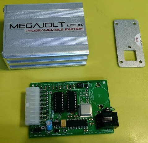

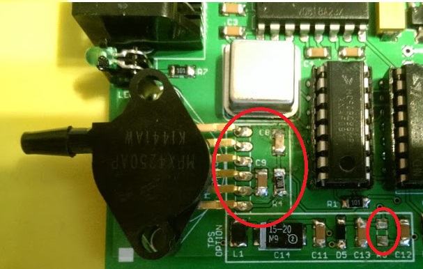

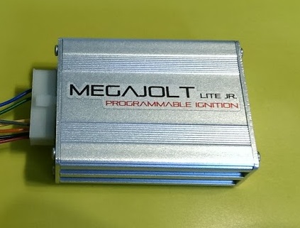

Having read up on the work involved in changing from TPS to MAP I thought I'd have a go. The transfer involves de-soldering one resistor and adding a MAP sensor two capacitors and one resistor. The resistors and capacitors are small, surface mounted items. Below are some pictures showing the unit as purchased, stripped down, the new parts (note: resistor out of square but is works and its tiny so its staying that way), the unit rebuilt with vacuum hose attachment and a picture of a capacitor on top of a penny for an idea of size.
Megajolt as purchased
Megajolt taken apart
Mega open.jpg (69.51 KiB) Viewed 7058 times

Photos to show the board, highlighted areas showing resistor R3 removed and new components added and completed unit.
Board with new components
Mega board done.jpg (87.34 KiB) Viewed 7056 times
Rebuilt with vacuum hose fitted
Re: Megajolt
Postby Rich » Wed Apr 01, 2015 9:24 pm
All looks good from here, the MegaJolt was probably the best thing I ever did to my convertible.
