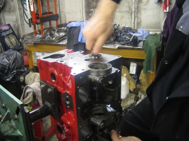

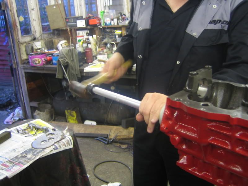

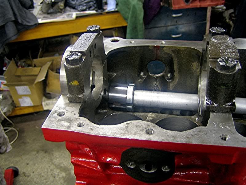

Postby ACDodd » Wed May 27, 2009 12:09 am
I use a pukka tool;
It leaves no marks on the bearings;
Somtimes the front bearing comes up tight, but using a bearing scraper to ease the fit is all that is required.
I even get contracted out to my local engineering shop to install cam bearings in small and big block yank V8's with the same tool.
When properly installed and fitted the cam should glide in and turn freely with no tight spots.
