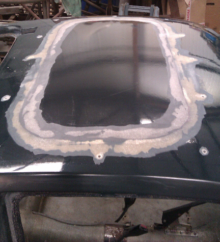

Desmond didn't like the original grey colour and wanted something more vibrant, so a full respray was in order. He also didn't like the leaky old sunroof, with its rotten seals and rusty clips. In fact Desmond wanted a solid roof and the best way to do that is to mould the roof in place. So the first job was to make a mould for filling in the sunroof. Fortunately, I now have a Mk3 Coupe of my own, waiting for its own rebuild (someday!), and it does have a solid roof so the roof was polished up and used as the plug for a new roof mould.
Roof polished up ready for laying up mould
Blue car roof.jpg (166.85 KiB) Viewed 17443 times
The rest of the car was not as smart, but I still didn't want to cover it with splashes of resin so I masked off the rest of the car with plastic sheeting and then layed up the mould in the traditional way: First the roof got six coats of wax, then I applied two layers of gelcoat - I figured that I would probably be using this mould again - before laminating with six layers of CSM and a section of coremat for extra rigidity.

With the car rotated on its side, it was an easy job to fit the roof mould. However, I wanted a good tight fit as I wanted the new section to be perfectly aligned with the original roof line to keep the filling, sanding and flatting to a minimum. So as well as some G-clamps I used a dozen bolts through both the roof and mould to clamp them tightly together. This of course meant drilling holes in both the roof and the mould, but the holes in the roof would be easy enoughto fill with bridging filler later on.

The mould had off course been prepared with six coats of wax and a coat of PVA, whilst I had also polished and waxed the old roof surface so that any excess resin that got between the mould and the roof would not stick to the roof - in the event I saw none so I must have got the mould fitting pretty snugly.
Also before fitting the mould I had taken the grinder to the inside edges of the opening, feathering back the first four or five inches (sorry to the continentals for the continued use of imperial measures, but I started on cars working with my Dad who was a good old fashioned British engineer and used good old fashioned British units) of GRP to give a tapered edge. This meant that I could apply progressively larger pieces of mat to increase the overlap and blend the new section into the old smoothly. But the first step of course is the gelcoat and with the car now fully inverted, painting this in was simplicity itself. Being a Midas, the original gel is pretty thick, so I double gelled it to match:
Opening now double gelled - note also the tapered edges.
Gelled opening.jpg (271.19 KiB) Viewed 17442 times
