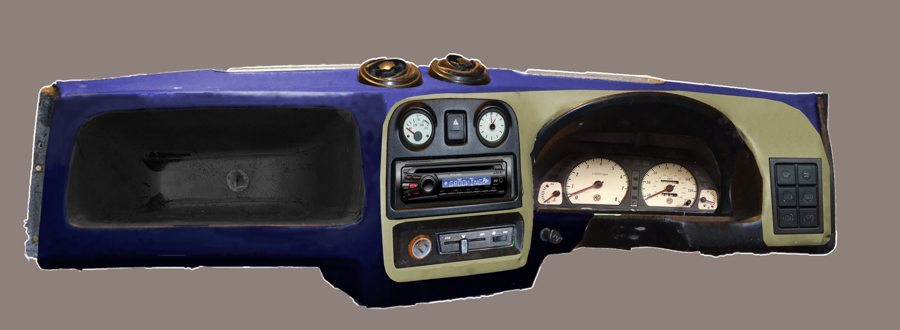

The dash is a bit of a challenge because when got the car first time around the dash was pretty wrecked and which I managed to work around in the process of fitting the MGF pod. It's not faired too well in the last ten years gaining more holes and water damage. I'm playing around with options at the moment but think I'm settled on the version below. Keeping half the previous skin panel covers the gaping holes in the original moulding the switches are Range Rover and the radio moulding is MGF. The plan is to cover the dash in Prussian blue and Lightstone beige vinyl to match the leather on the seats and the interior plastics which are a cross between Mini Mpi and Metro.

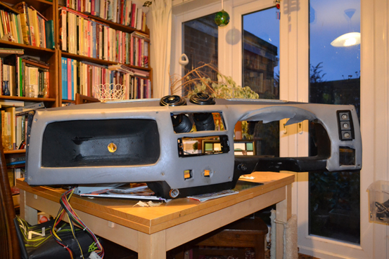

It was finally time to tackle the dash this weekend
roughing out the shape
Sanded back and shaped
Finally trimmed and test fitted
Hopefully will get the main dash done tomorrow :-)
