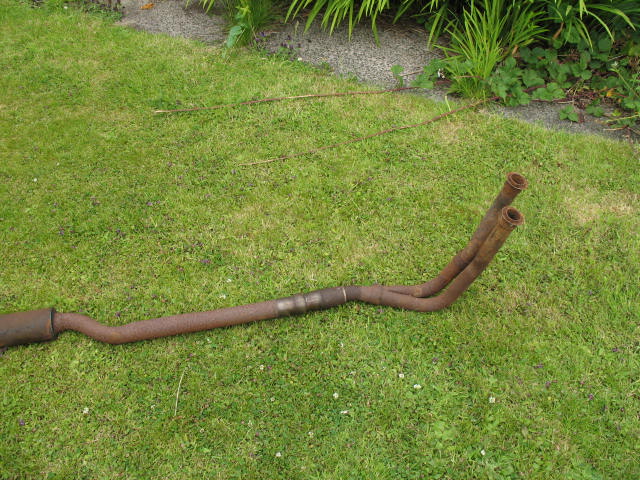

I'm going to guess that most mk3's had the cast Metro exhaust manifold and something like this exhaust, I know the exhaust varied a bit through the years.
This one burnt right through the grp and melted the sound insulation too, although not with me driving as it hasn't been running with me.

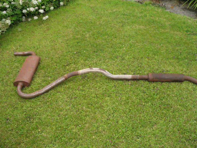

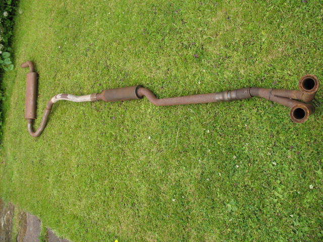

fozzza wrote:By the way very useful photo, part of the exhaust was missing on my MK3 and so its good reference to see how it is routed :? .
No problem :)
