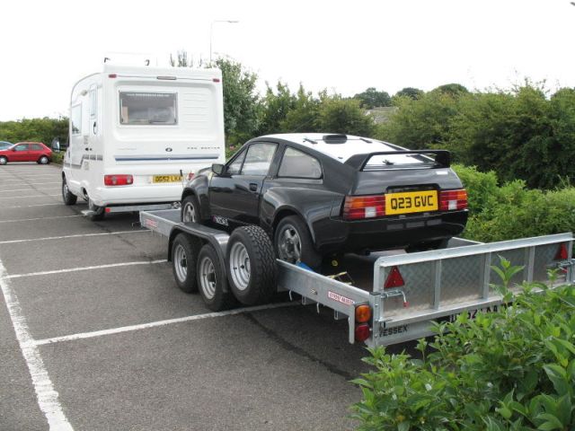

My MK3 coupe had some 4 lb/in run flat springs on standard Spax dampers to lower the car, it ran 150 lb/in springs, at the time I thought the ride was perfect at the rear.
I wouldn't like to say what length and rate will suit you though, but the run flat will allow you to achieve a lower ride height on standard dampers.
http://www.dfaulknersprings.com/acatalo ... pring.html
Q23 back.jpg (97.81 KiB) Viewed 22631 times
and one with a bit more fluid in the front displacers
