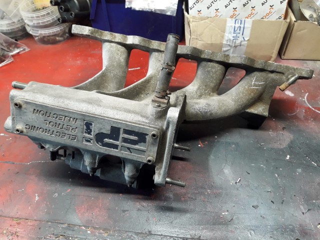

As espected I have a problem with the inlet manifold suzuki MK3 .
The manfold is too big and hits the bulkhead ,the inlet is +- 20 cm and the distance engine - bulkhead is +- 15 cm , so difference of 5 cm !
If I change the angle from 7 ° to 13° by lifting the rear mount than the manifold passes........... but than the driveshafts become to high and hit the subframe .
A solution would be to lower the engine at rear and front and make the angle 13°, but than the engine is too close to the ground.
I am looking for a MK1 inletmanifold and hope this will solve the problem :?:

Postby ilmung » Sat May 11, 2019 7:45 pm
Yes I thaught also to short and angle the Suzuki MK2 manifold but the manifold would hit the bonnet and correct welding wasn't easy at all
Finally I took a MK1 manifold which has another construction and NO problem anymore to pass the bulkhead , now I have a lot of space !!!
The diameter of the manifold and the gasthrottle of the MK1 is 42 mm instead of 48 mm with the MK2 .
I 'll use the gasthrottle of the MK2 ( 48 mm) and I will make the diameter of the inlet of the MK1 to 48mm .
The threadholes of the inlet MK1 do not match with the threadholes of the MK2 gasthrottle , therefore I will use a flange which takes on on one side the inlet MK1 and
the other side takes the gasthrottle MK2 .
Just looking at the design of the MK1 and the MK2 ,I have the impression I 'll lose some horsepower ( I am not sure ) but the manifold do not hit anymore the bulkhead :D
Also I have to give up the cold start function , the engine will run jerky by a cold start ..... but only for some minuites .

As said before i have used a MKI inlet instead of a MK2 inlet (MK2 hits the bulkhead), much more place and the manifold do not hit anymore the bulkhead and so finally nothing to change at all .
As the diameter inlet of the MKI is 42mm and the MK2 is 48 mm ,I decided to use the gasthrottle and the maf of the MK2 ,which will give more power and also I will not have a problem with the ECU later ( I hope :) )
I also changed the side of the gasthrottle from the right to the left and I have now place again for the original place of the brake and clutch cylinders on the bulkhead .
In that way I can use the original pedals and I do not not need a pedalbox or change the brake/clutch cylinders to the left side !
