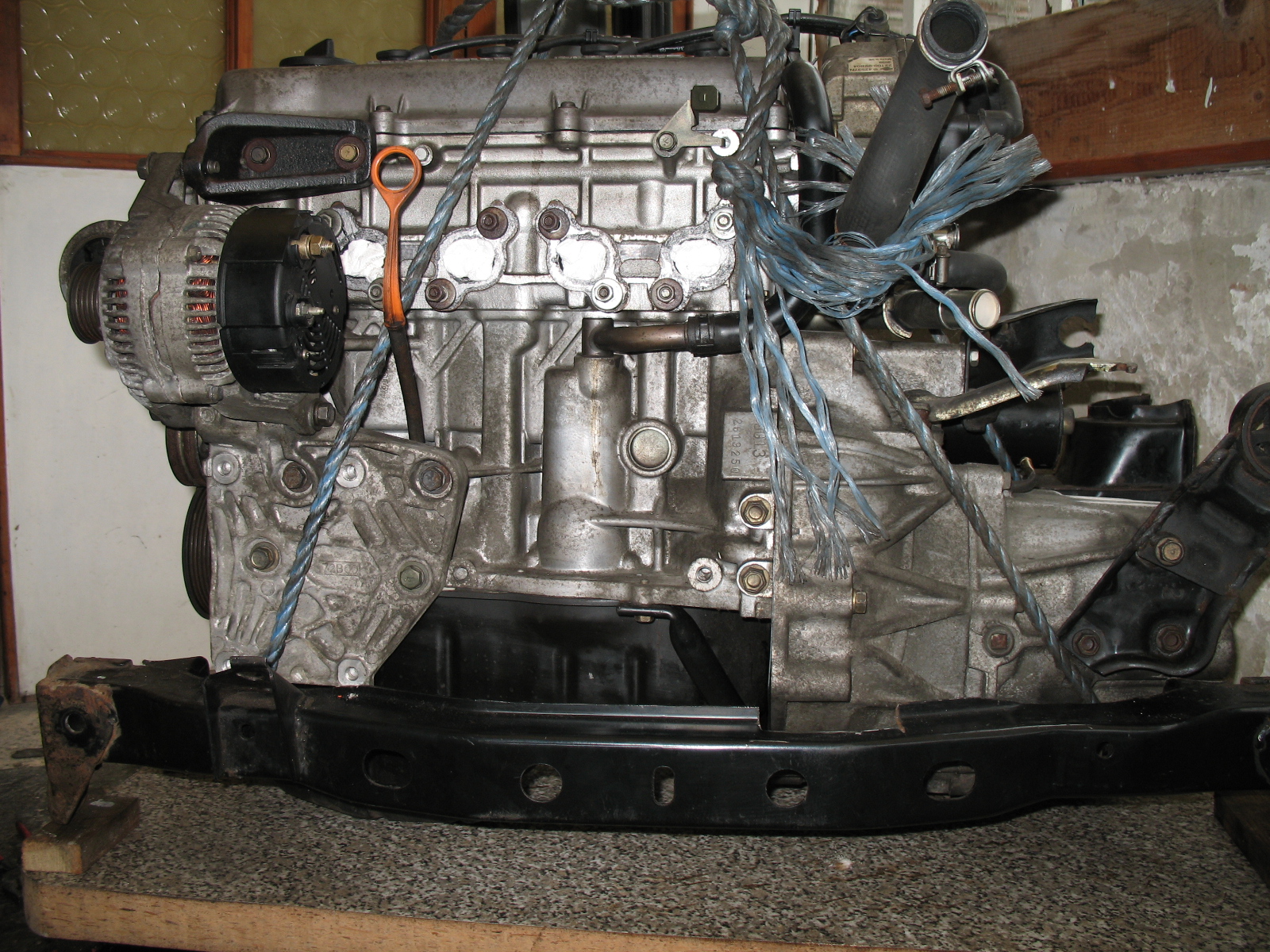

Postby Stuart » Wed Dec 09, 2020 8:37 pm
Last time I checked it it will fit.

Re: Micra engine
Postby wolfie » Wed Dec 09, 2020 9:36 pm
Stuart wrote:Last time I checked it it will fit.
Are you doing the conversion as well then? I'm hoping i'll be able to find a 1.3 beater so I can just swap out what I need and sell the rest for scrap

Postby Stuart » Wed Dec 09, 2020 9:56 pm
Well if I ever get around to it that's a yes, struggling to find any motivation to get on with it. It'll make for a very nice car though.

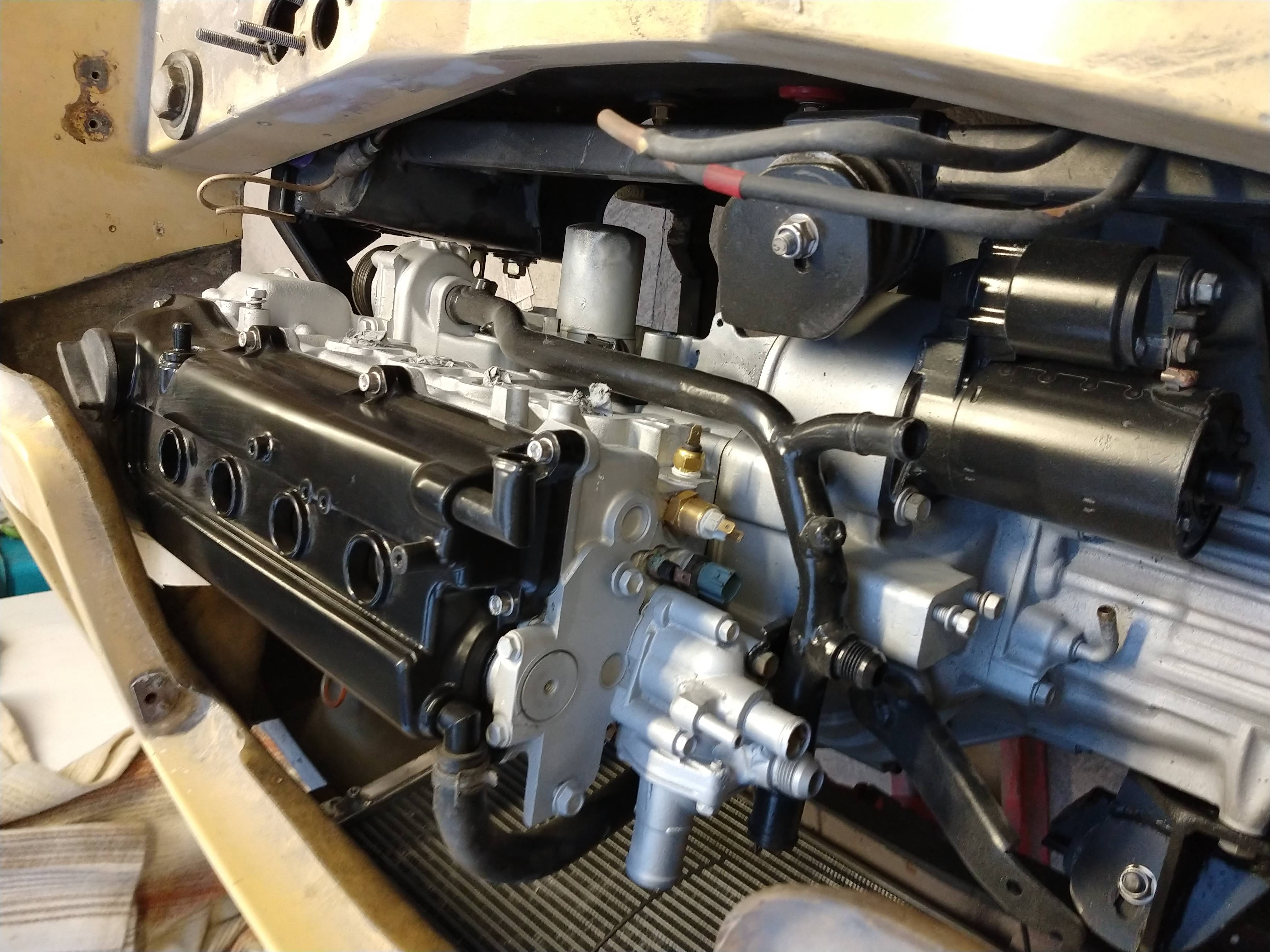

Postby l_jonez » Sat Dec 12, 2020 2:11 am
I've got one in my MK2

Re: Micra engine
Postby wolfie » Sat Dec 12, 2020 7:13 pm
Nice 1. Was much work needed to squeeze it in other than tweeking the subframe?

Postby l_jonez » Sun Dec 13, 2020 11:36 pm
wolfie wrote:
The engine encroaches into the o/s headlight so that needs a solution. The rest is just subframe mods

Re: Micra engine
Postby wolfie » Tue Dec 15, 2020 12:53 am
l_jonez wrote:
wolfie wrote:
I've been thinking about the headlight issue and to keep the frogeye look I may look at changing from 7" headlights to 5 3/4" so they can move forward without looking like a choking frog
