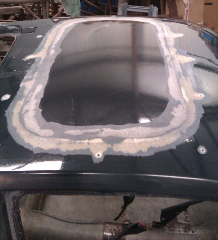

The next step is indeed to laminate some strips of glass CSM over the top of the join. The new section may have got a good bond, but only from one side. I wanted to be sure that the roof was as strong as, if not stronger than the original, so I had to take the angle grinder to the top surface and created a tapered area around 3 inches wide either side of the join line to allow additional glass to be laminated on top.
- Roof join ground back in preparation for laminating in additional CSM strips
- Roof ground back again.jpg (215.68 KiB) Viewed 17445 times
To achieve a good smooth taper, I start with a flexible grinding disc in the angle grinder, probably P80 grit. Once I have roughed out the taper I smooth it off using P120 production paper on my trusty old 3M body file. It is important to achieve a smoothly blended edge to the old gelcoat so that the new filler blends into it gently. Otherwise sudden changes between gelcoat and filler can show through the paint as shadows.
The sharp eyed will have noticed that I also tapered back around the bolt holes. These were filled from both sides with bridging filler (glass loaded polyester, such as Isopon P40).
Two layers of CSM strips were then laminated across the join, starting with one layer about 4inch wide and then a layer at 6 inch wide. Once that had set hard it was time to apply the filler.
