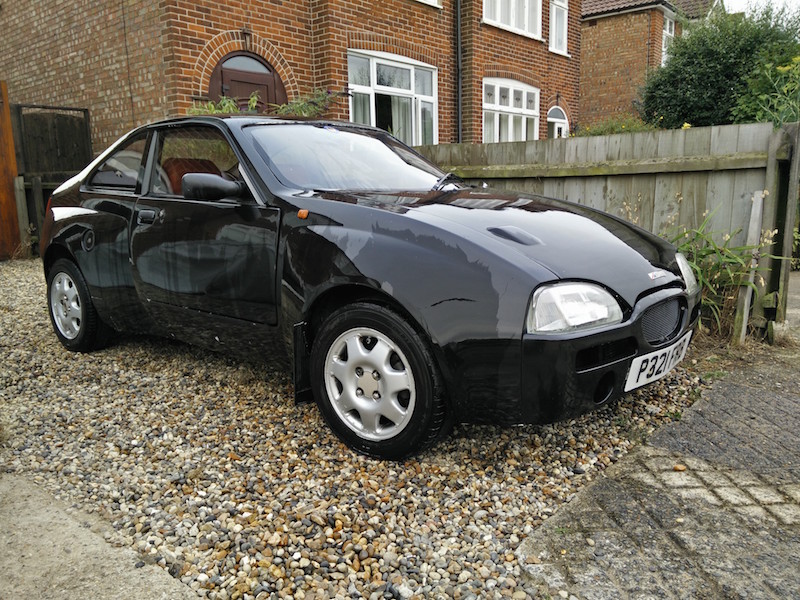

The black paint on white gel looks quite ropey up close, but from a distance having been washed does look rather good!

Postby Jin » Sat Jul 18, 2015 8:13 pm
Tidy car mate, it looks rather nice, I do like the shape of these,
Has it had a respray then?
