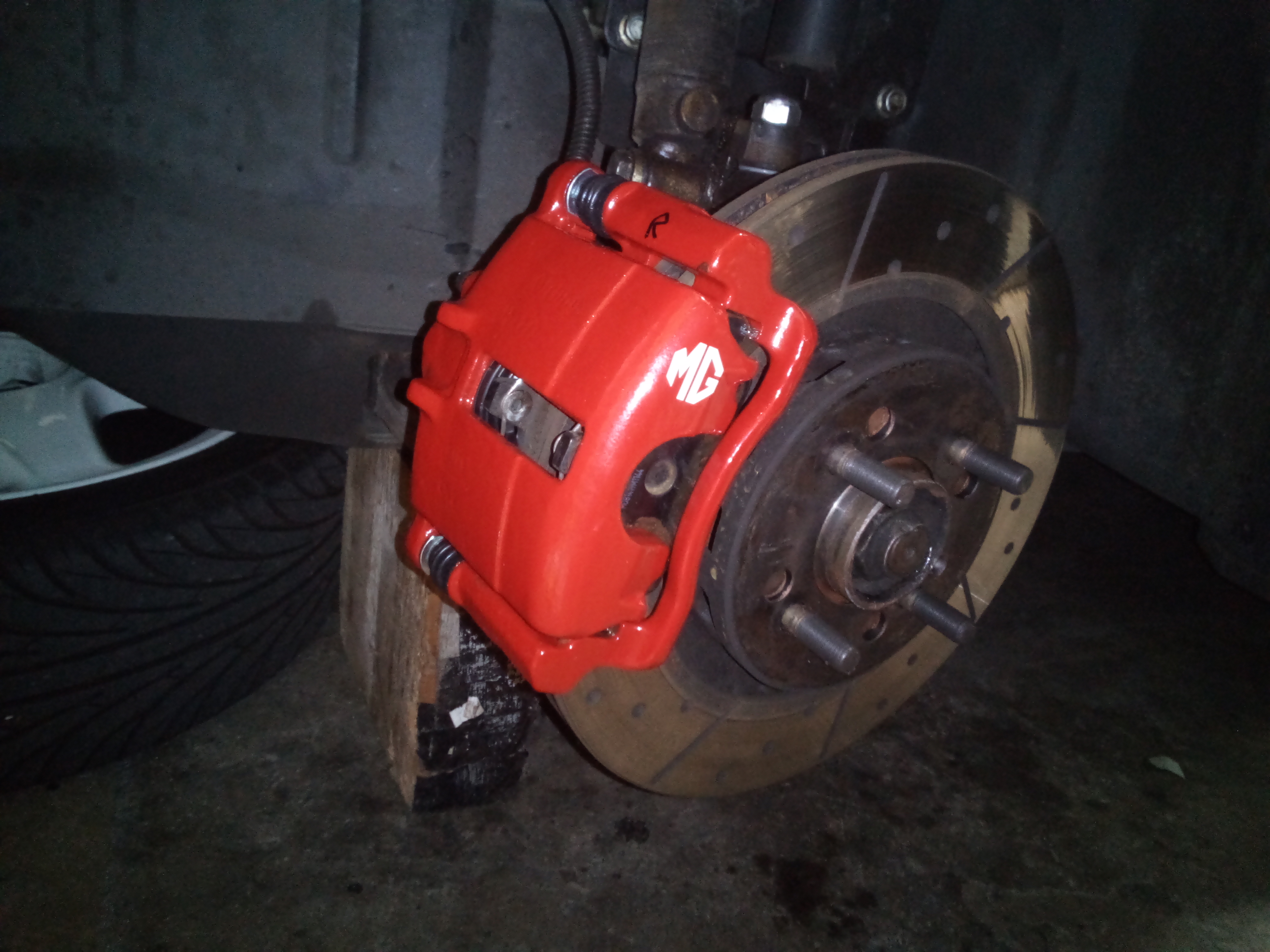

Postby Jin » Wed Oct 10, 2018 11:30 pm
My new old old new old brakes from an mgf.
280mm of stopping power

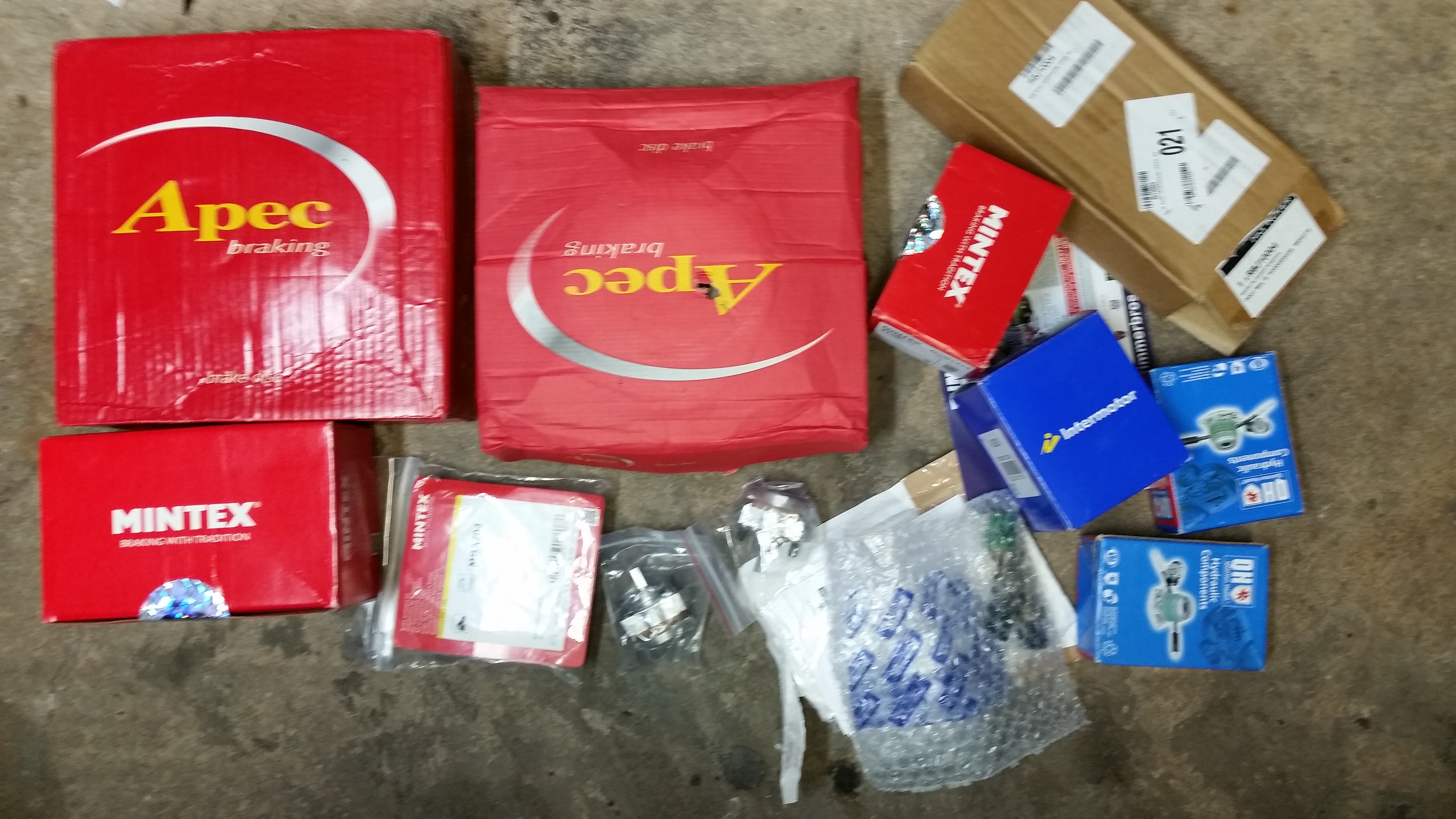

Re: J171 NJO Cortez / 2+2 rebuild and modifications
Postby Jin » Tue Oct 30, 2018 9:02 am
It's like Christmas :D

Postby Jin » Tue Oct 01, 2019 8:06 pm
It's been a while since I've updated this and I'm still seeking out an alternative to photobucket.
However in the meantime all images as re viewable on Facebook so all should be seen
Anyway new brake calipers
https://m.facebook.com/story.php?story_ ... 1812351048

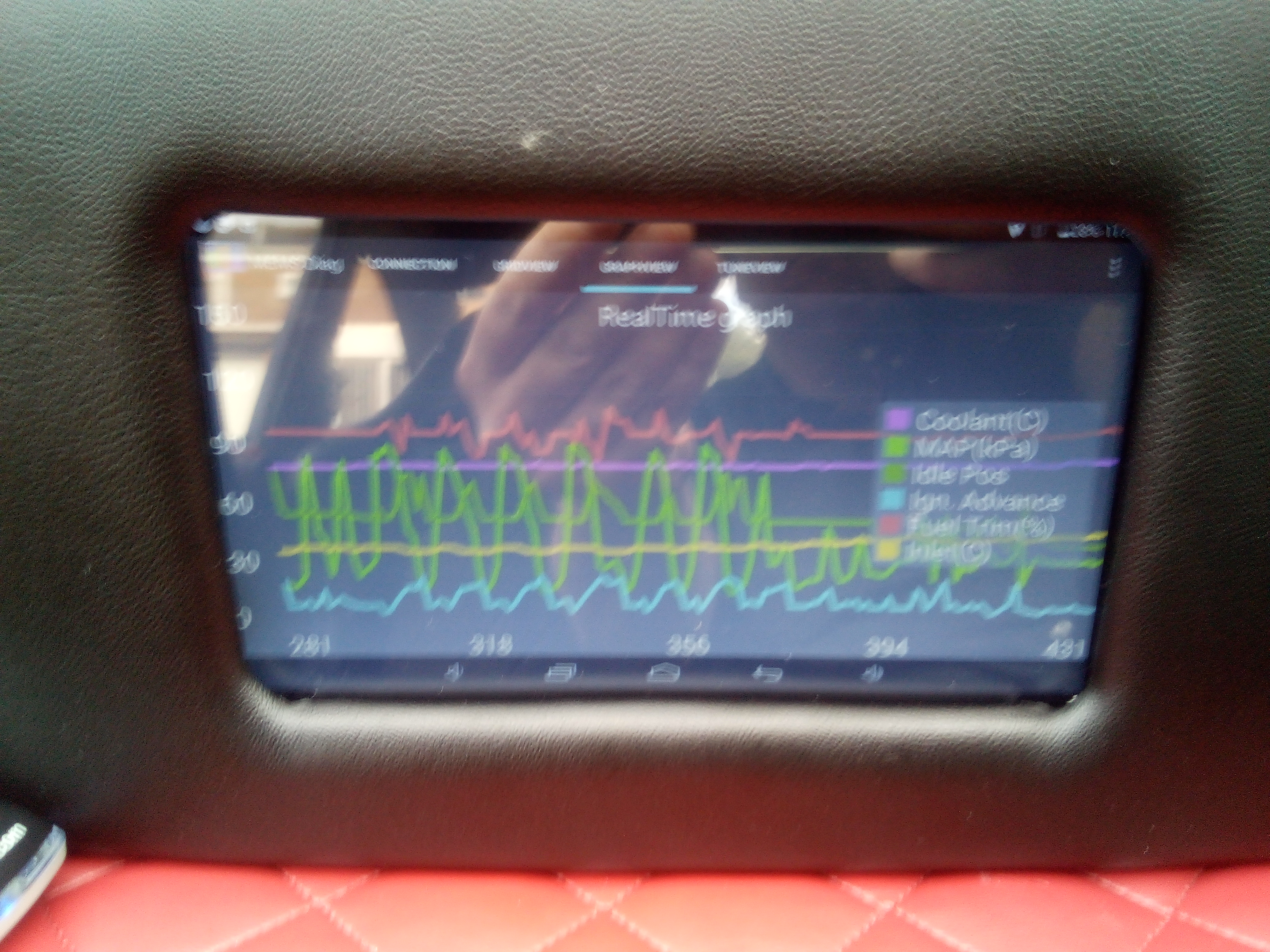

Postby Jin » Sun Oct 06, 2019 7:49 pm
Touch screen dashboard and diagnostic system
