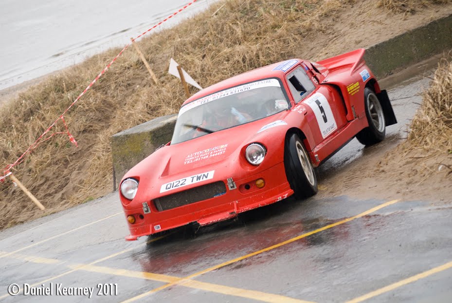

Started fitting some of the lights and new number plates - coming together - will get some pics up, but in the meantime heres some pics of our Race Car - which we were making the Midas a MINI version of! Thinking of painting the centres of the Revolutions white to match the way the Skyline is.

Postby Rich » Tue Jan 10, 2012 12:29 pm
Is that a Darrian?
Posts: 1283
Re: Midas Silver - aka Minipaw - rebuild
Postby Stuart » Tue Jan 10, 2012 12:33 pm
Heck I don't even know what the car in the photo is :?
I'd rather see a photo of the Midas though, the Acclaim lights look good, Cibie ones too, ones on ebay at the moment aern't cheap though http://www.ebay.co.uk/itm/TRIUMPH-ACCLA ... 3368855aa7
Postby Stuart » Tue Jan 10, 2012 12:36 pm
Rich wrote:Is that a Darrian?
Oh yes silly me, watched them rallying a few times :oops:
