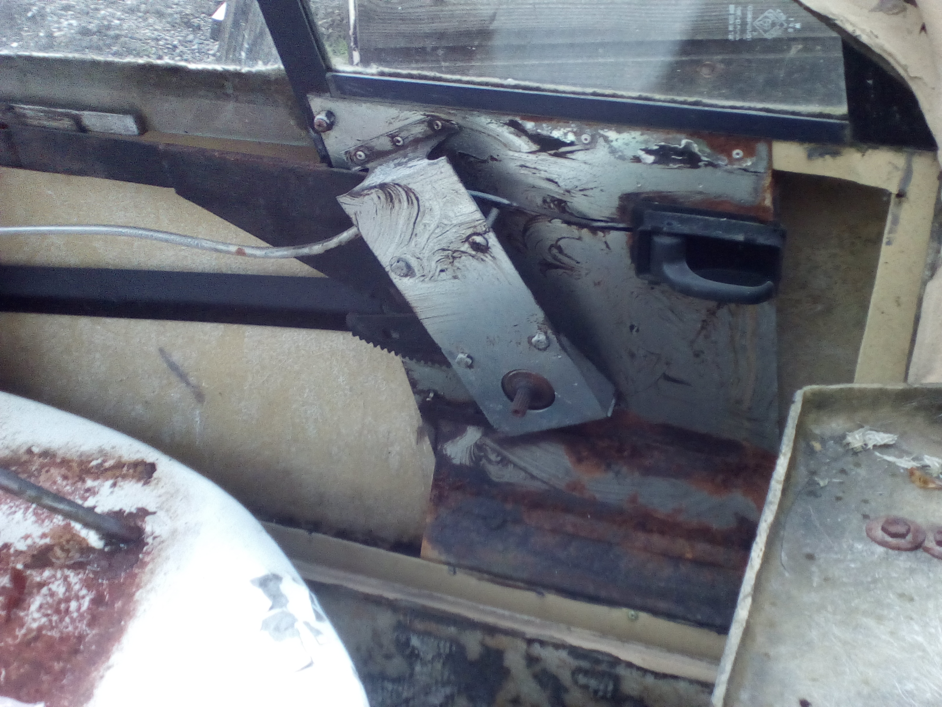

7. From what car are window mechanism? As my Midas came without doorcards, then inside of the door was clearly visible and to roll up and down the window, there were those interesting “winders” that weren’t fixed to mechanism:
As handle isn’t fixed, under it comes out this rectangular base:
I’ve read and been told, that door locks, handles, window mechanisms with winder handles and hood cable should be from Ford Fiesta Mk1, but after some research in internet I found only one Fiesta Mk1 window winder handle, and it’s fixing is “star”, not rectangular:
https://www.ebay-kleinanzeigen.de/s-anz ... 5-223-5213
Could this add have wrong picture? Or in UK Fiesta window mechanisms were different? Or my Midas doesn’t have Fiesta mechanism? Last one of course rises lots of other ones, starting with from what it could be then?

7 Those TR7 filler cap style winders where to my knowledge an early idea that didn't work at all well in practice, I understand changed to a normal winding handle, I guess that's when the change to Fiesta parts occured, certainly yours are not Fiesta ones as you've already surmised.
I'll see if I can get a photo of the Fiesta winder.

7. I can't help re the specifics of your winders, but my Fiesta Mk1 winding mechanisms did have modifications made to the metal "arm" to allow it to fit in the door. It may be that you could drill the rivets out and fit a different winder stub?

7. Thank you for explanation and picture of Fiesta winder. I see, that even mechanism on my Mk1 is different than Fiesta’s, not only winding handle. Stuart, this is interesting info, that those TR7 filler cap style winders could actually be try and error from factory. If so, I could try to live with them. They are huge and junky and quirky, but different :) When doorcards and those handles are in, I’ll see if I need to make normal ones too.
