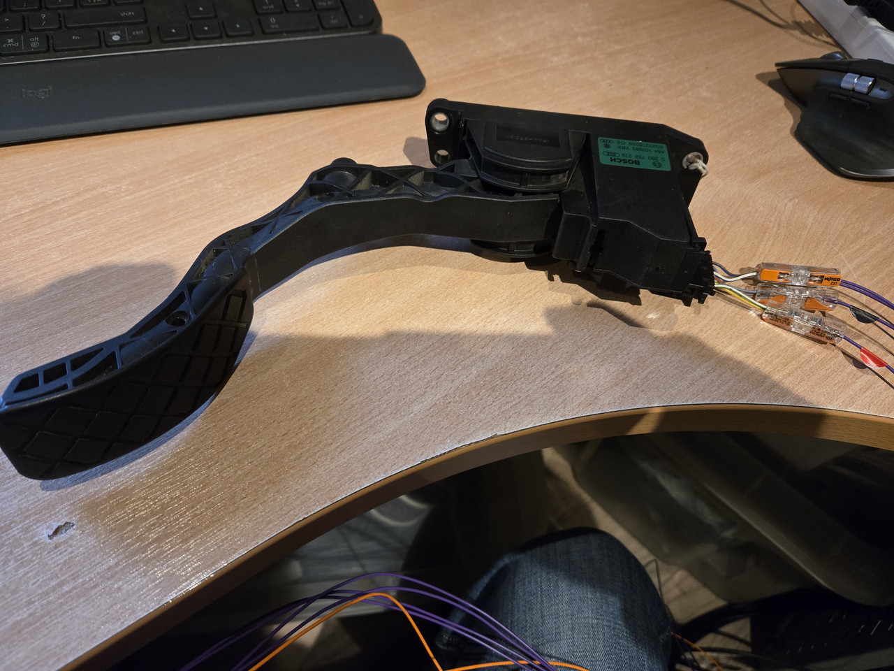

Also recently received the zombieverter Vehicle control unit (VCU) off Damian on the Openinverter forum (https://openinverter.org/forum/) and a wiring loom off aliexpress.
I will be spending some time over Christmas getting to know the zombieinverter which can be accessed via a local webserver it presents via esp32 type chip with built in wifi and bluetooth.
First thing to do is fire it up, update the firmware then think about wiring in the dual channel throttle pedal. The reason for dual channels on the throttle is for redundancy. First off I bought a VAG circa 2005 SEAT Ibiza pedal as a test. Not sure if this one will do but will give it a whirl. Reason for choosing this one is because it was quite small. Which will be a requirement in the Midas footwell. Apparently they are pretty standard across the VAG group of pedals but will soon find out. Otherwise I might be looking at prius or leaf pedals.

Postby manifold » Mon Dec 29, 2025 8:01 pm
Had a look at Gregski's youtube post on the openinverter forum:
https://www.youtube.com/watch?v=JLN8A1YEx6M
about calibrating the pot values for the zombieverter with my VAG SEAT throttle pedal.
Here are my values:
Pot 1 min: spot value 308: set my parameter to 320
Pot 1 max: spot value 156: set my parameter to 166
Pot 2 min: spot value 1855: set my parameter to 1845
Pot 2 max: spot value 862: set my parameter to 852
Here is an image of said pedal loosely wired in with some inline wego 221s (for testing out purposes only):
As we have a slanted floor half way in the floor/bulkhead area of our Midas Mk3 below where the throttle bolts to the bukhead I aim to offset it towards me by bolting the pedal to some 60mm ally box section I have lying around which I will then bolt to the bulkhead using 6mm bolts. This will offer the pedal box enough to not hit the floor before getting full throttle for my situation. Access to bolts fixings/nuts will be by using a hole cutter in the side of box section to get a spanner/fingers in to bolt the pedal up to the box section. The box section to the bulkhead. This aligns up all three pedals roughly. (although I wont have a clutch pedal obviously).
