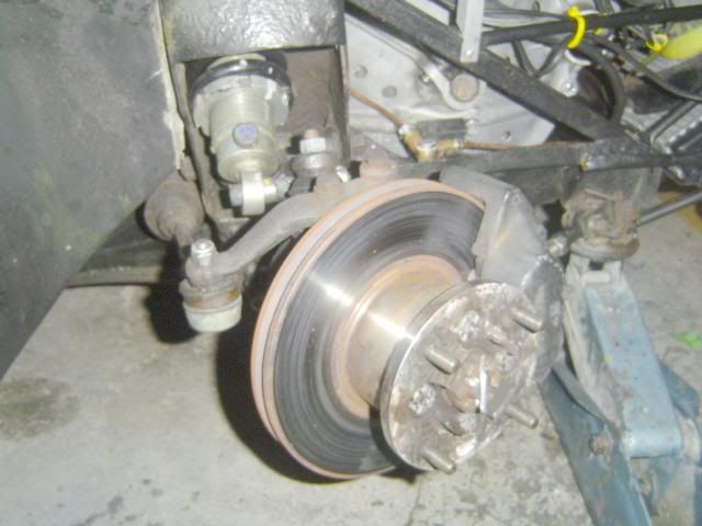

Heres another perspective on coil overs.
This one was done to the Granny Smith Racing Mini Marcos, but I guess it could be applied to any Midas.
Needs a hole cutting in side of hydrogas housing and an ear to pick up inner mounting point.
