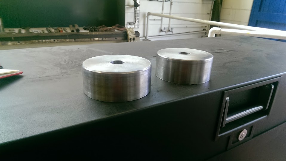

My uncle has a moke with minitastic springs, the softer option of the three grades available. It's is comfy, as comfortable as you could expect to be in a car without doors, but there is a lot of body roll (2cv levels of roll!). I'm hoping to go for standard springs (rather than hard or soft).
Today was quiet at work so I made my turrets, going to autojumble at Newark on Sunday to see if I can get some 7078 (I think) aluminium to make my own short HiLo's.

streetsy wrote:My uncle has a moke with minitastic springs, the softer option of the three grades available. It's is comfy, as comfortable as you could expect to be in a car without doors, but there is a lot of body roll (2cv levels of roll!). I'm hoping to go for standard springs (rather than hard or soft).
If you have a dig around for my thread on the subject you'll see I modified a set of standard Hi-Los by machining them to fit upside down.

Postby streetsy » Sat Aug 23, 2014 6:59 am
I have seen your thread, hence the hole in the top of the mount, if I can't get any aluminium at a good price I think I'll be modifying a set of hilos in the same way
