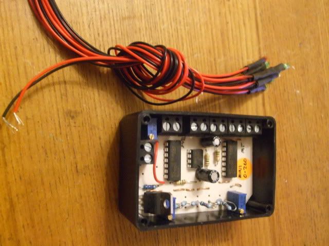

One of the guys (Spiyda) on the 16v Mini Forum has a business making LED light units for Minis and Harleys and he's branched out into electronics, I've bought on of his adjustable fuel gauges (complete with anti-slosh circuit).
This is what you get..

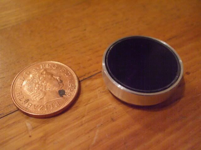

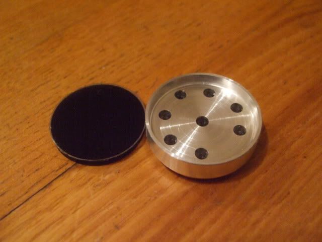

As you can see there's a bunch of LEDS that you make up into your own gauge so after a bit of playing on the lathe I came up with this..
The dark circle is a piece of smoked plexiglass that I cut out with a hole saw so when fitted it looks like this..
The LEDs were stuck into the rear of the gauge with JBWeld and after a bit of faffing about fitted into the dash..
The red LED that shows empty is in the centre of the gauge and only lights when appropriate, the points where the full and empty lights come on are individually adjustable as it the brightness of the LEDs overall.
