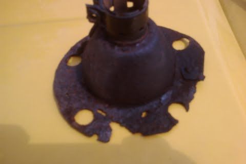

I really have to write up some of the stuff I have done to her: mostly tales of how much rust you can get in a rustproof car combined with a litany of 'money saving' bodges that I have had to unbodge, potentially lethal neglect and more rust...
For example:
I enjoy wreck diving and, frankly, parts like this look like they came from this Beaufighter
rather than the cabin of a Midas
The bottom line is that the car that it becomes increasingly clearly miraculously managed to not only drive to Stoneleigh but enjoy immensely was hanging together: for example: the 'rubber' disk under the steering column was badly torn and generally had the consistency of stringy marshmallow. Fortunately, this rather effectively camouflaged the fact that the pinch bolt underneath was chillingly loose. All of this I was utterly oblivious to, which is hardly embarrassing at all. Any lack of response to deflection of the wheel I was blaming on the uneven hydrogas setup...
