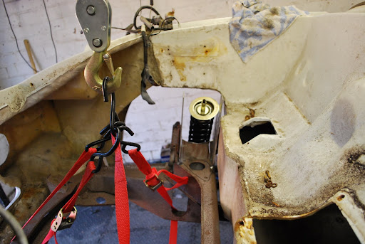

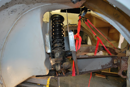

Postby Alan D. » Sun Mar 20, 2011 8:18 pm
Stuart wrote:Looking good Alan :)
So it all seems to be working, there is lots of room, the coilovers are inclined at about 30degrees from the vertical and it looks OK to me, does anyone have any constructive comments? The only items I think that will be need to be relocated are brake pipes!
Alan

Postby Hans Efde » Sun Mar 20, 2011 9:01 pm
Because the shocks are leaning inwards, I think you have to compensate for the inward forces. I am not sure these side slabs can take the load. Maybe a square piece of tube that goes from the top of the turret in say a 45degr angle towards the subframe. It would be nice to have a bar from left to the right turret, but I think that won't be possible.
Gordon Murray had a torsion beam mounted between the top mounting points of his front shock absorbers, but obviously he didn't have the trouble anymore of an engine that had to be fitted in between. Check out the pics of his mid engined bronze on the interweb.
For the rest thumbs up for you Alan.
Cheers, Hans

Postby Alan D. » Sun Mar 20, 2011 9:22 pm
Hans Efde wrote:Because the shocks are leaning inwards, I think you have to compensate for the inward forces. I am not sure these side slabs can take the load. Maybe a square piece of tube that goes from the top of the turret in say a 45degr angle towards the subframe. It would be nice to have a bar from left to the right turret, but I think that won't be possible.
Cheers, Hans
Don't worry Hans, there is a lot more bracing to fit! I have thought about a side to side (boy racer) strut brace, but the carb. and manifold may be a problem, before we go any further I'm going to try an MG TF turreted front subframe in to see how it looks. I'm encouraged by how much room there appears to be!
The diagonal brace from the top of the tower down to the subframe is a good idea.
Alan
