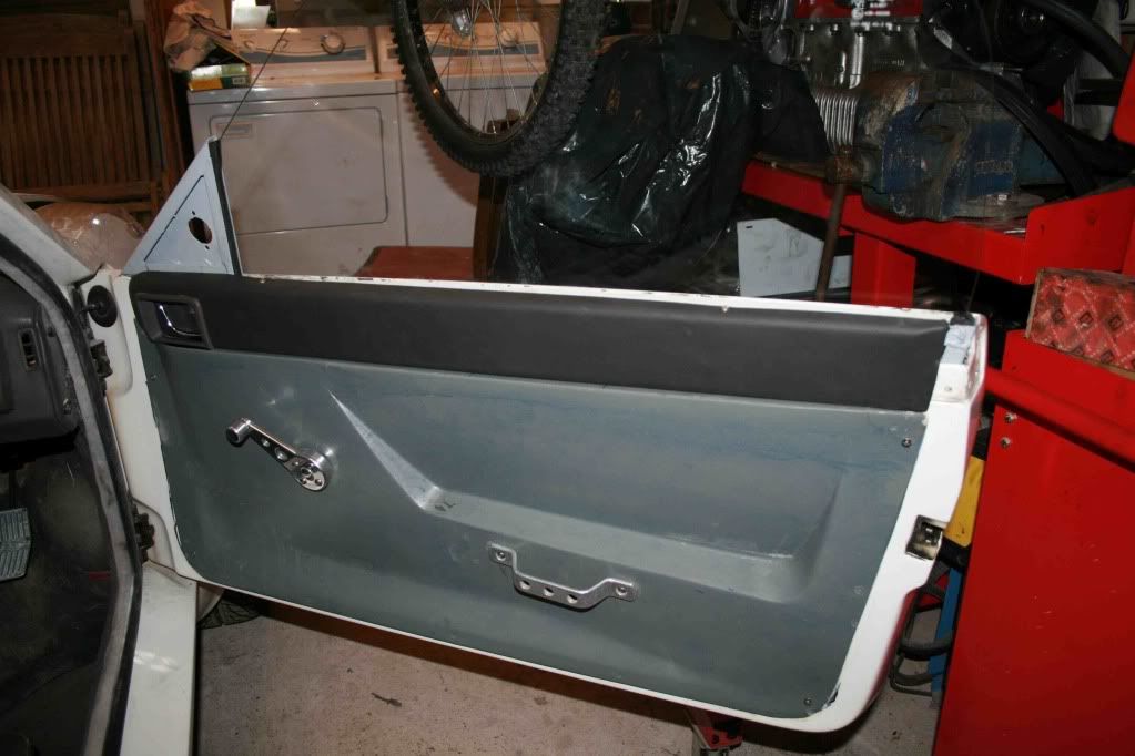

You will probably be able to use existing door cards if you reglass, recover and remount the door pull and opener.
I opted to get new door cards and use the rover 200 handles like Mike did.

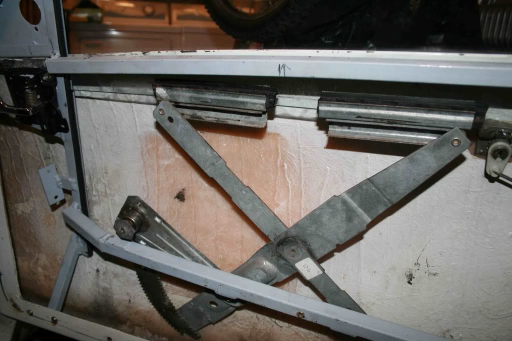

This is because the window winder mech only has one pivot on the channel. As the winder goes across the rail, either up or down it tips the glass forward or back, causing the jamming....meaning having to stabilise it with hand (not really ideal)
The later type has 2 channels/arms plus third lower stabilising arm as per metro and most other cars.....meaning the glass is stabilised at a set angle throughout its travel. The result is a lot better.
When I get a chance I will try and get a photo or two . Best person to be doing this really though is the man who sells them! Alistair. ;)
What I can say from memory is the box section frame is 20mm steel. Front and rear channels are wider than the early alloy ones, but fit correctly in the same door gap as the steel gauge is narrower than alloy.

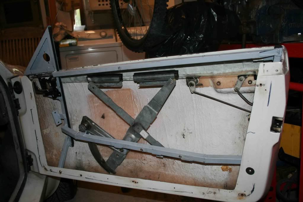

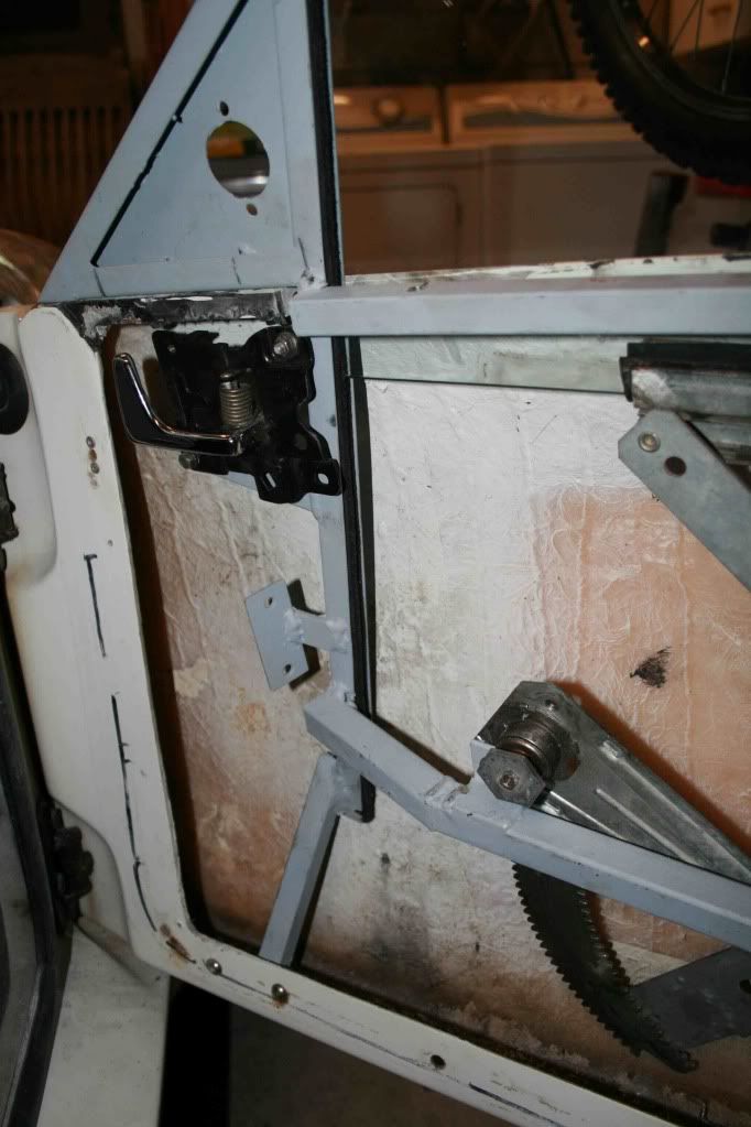

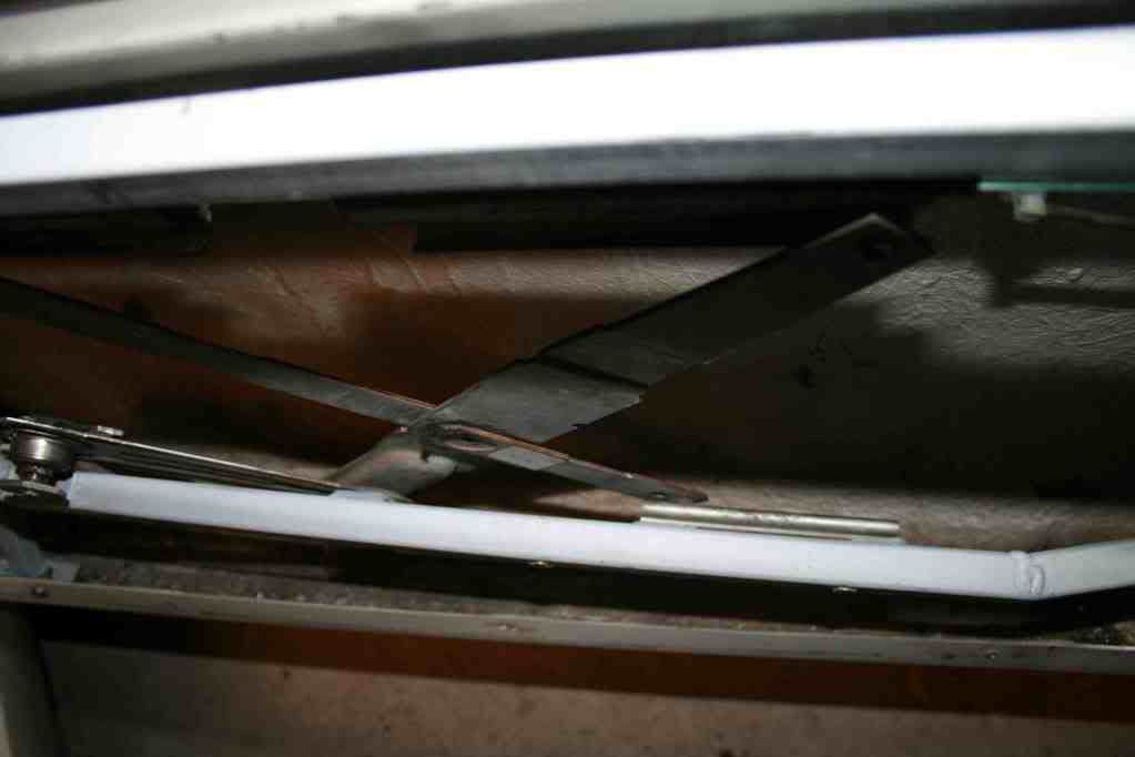

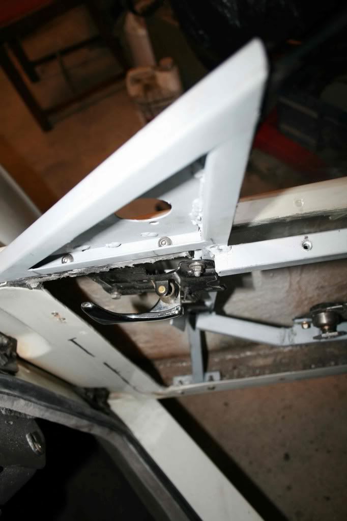

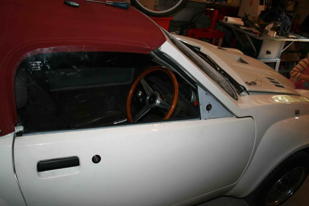

Postby manifold » Fri Jun 19, 2009 5:49 pm
Here you go Victor, as promised. Had a few moments to strip the door down. I hope you find it useful.
Please note its in unpainted, primed state. The outer diameter of window channel is 16.5mm. The inner diameter is 12.5mm, meaning a steel gauge of 2mm.
Bottom door card (as its a 2 piece door card) hasnt been covered yet.
Cheers,
David
Posts: 1818

Postby Victorc » Mon Jun 22, 2009 9:35 am
David,
Thanks for the photos.
I did not expect you to strip down the door just to take the photos!
This looks like the new arrangement that Alistair made for the convertible (Issues with SVA ?)
I see the opening mechanism is in a more convenient position too.
The glass is different, so a complete kit would be required, i.e.
Glass, framework, winding mechanism, door opener, and inner door cards.
I guess the new glass and door card would be from Alistair, and the rest of the bits from the Mk2 Metro (or Rover 100).
It looks to be a very superior arrangement, but I guess I will have to wait and save the pennies.
