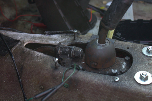

Wolfie, I'll need to do a bit more research here! In the mean times to get the car running & MOTed I've raised the gear change remote by about 1.5" to stop the knocking and be able to raise the exhaust at least 1" to reduce the grounding out. Had to cut a bit of the shell away and it seems to the job (hopefully I've managed to upload a photo below).
Longer-term intend to make something along the lines of what you’re going for - post looking at the link you provided I’ve searched some of the Mini forums and there are quite a few approaches out there for the racing scene, some very crude. One thing they all share is that they are all rigidly mounted to the car, so for a car that is going to see many road miles I expect this will increase the noise & vibration in the car but to what level? Also is there a need to more rigidly mount the engine to cut down relative movement between the engine & gear change remote (would hate to have large engine torques inducing inadvertent selections of neutral!)?
