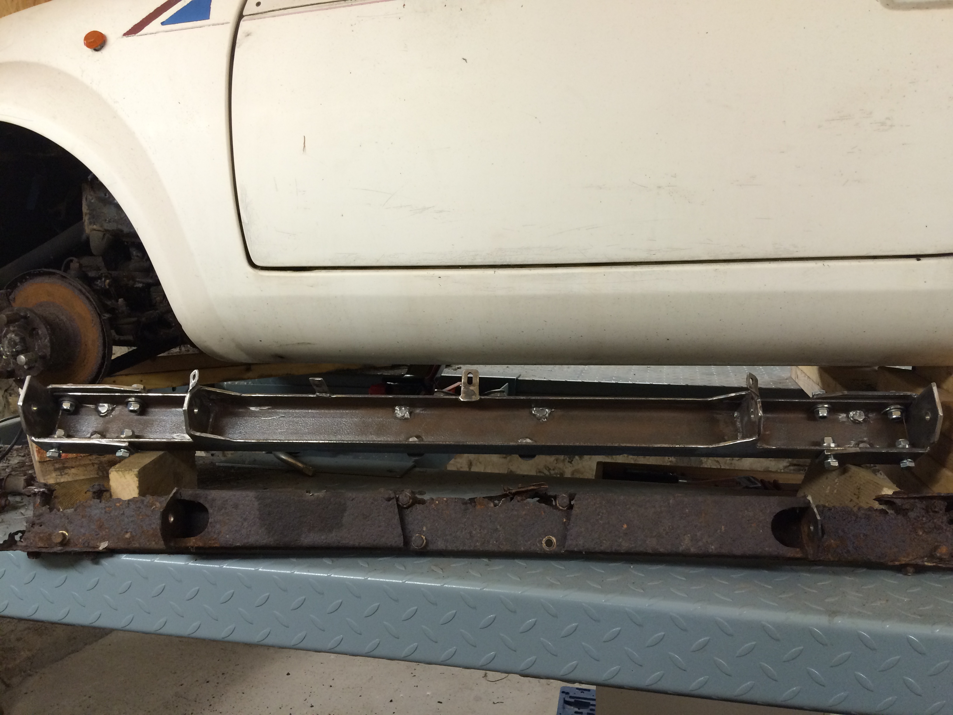

Many thanks for the drawings, Stuart, here's a little "before and after" picture.
Think I'll spray the old one gold and in for the Turner Prize!
Re: NEWBIE/AXLE
Very impressive, that'll take a long time to rot.

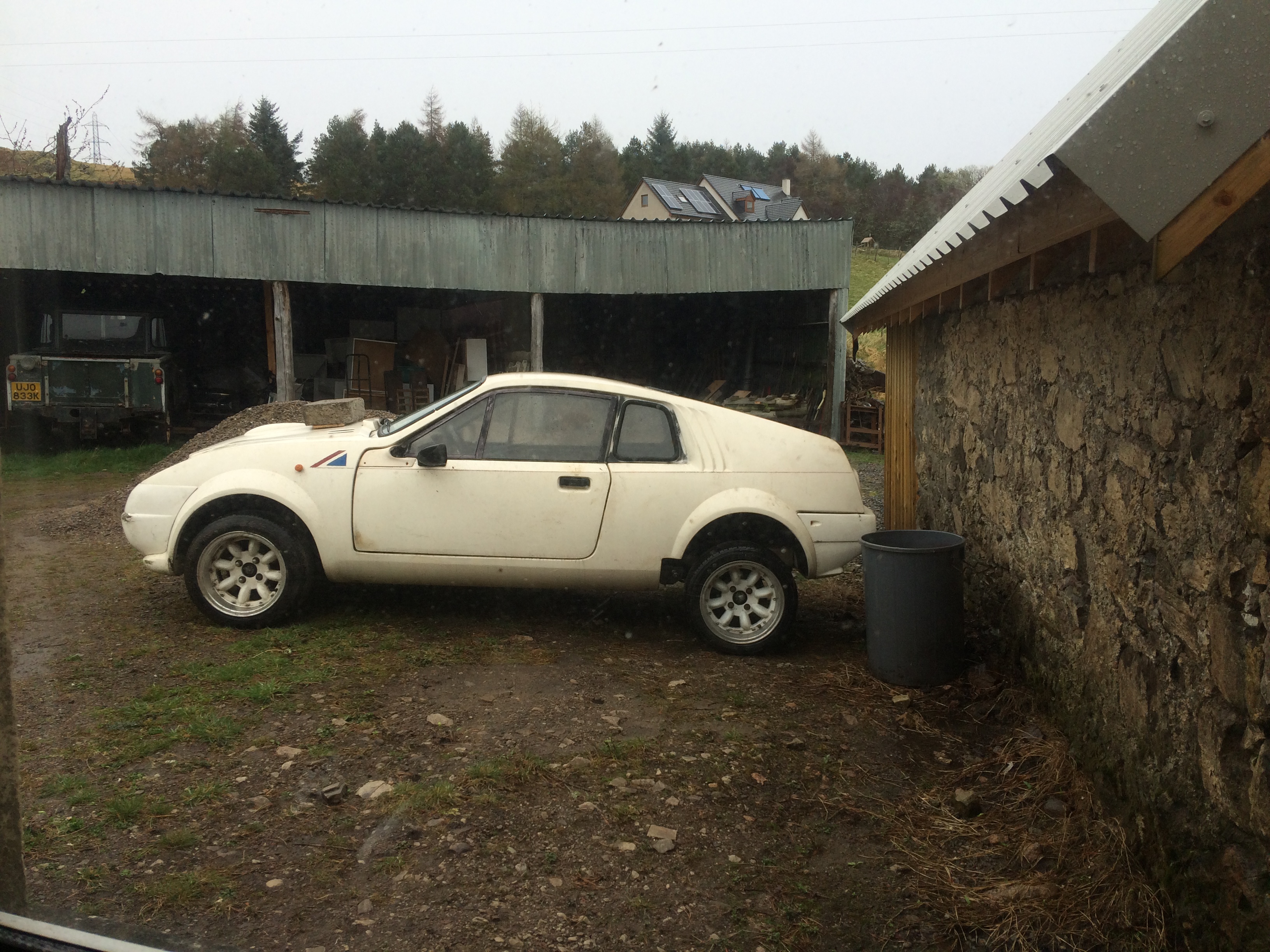

Our car now rolling again with all four wheels pointing in the right direction for the first time since we bought it!
Alas, now that the axle is sorted, the standard factory fitted Spax coilovers are making the arse end sit up even higher!
As they are banjaxed, I'm looking for a pair of bolt on replacements which will lower the rear at the same time
Any one found a good product that is currently available?

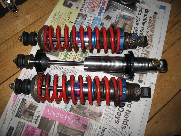

In my opinion the standard Gaz damper supplied for a Midas is 2" too long when fitted to a mk2.
They'll all make a damper to the length you ask for.
Dave at Dampertech supplied these AVO dampers for me when he used to sell AVO dampers, he also supplied the GAZ damper which works fine on a Midas Mk3.
This is that Midas Gaz damper fitted on full bump without a spring.

I can't remember the length exactly, I guess you could just ask Dave for a Midas one but 2" shorter, or erring on a less extreme one perhaps an inch shorter, then you can add a 4lb/inch run flat so that if you go for a racy rate of 110lb/in your dampers won't be at full extension.
