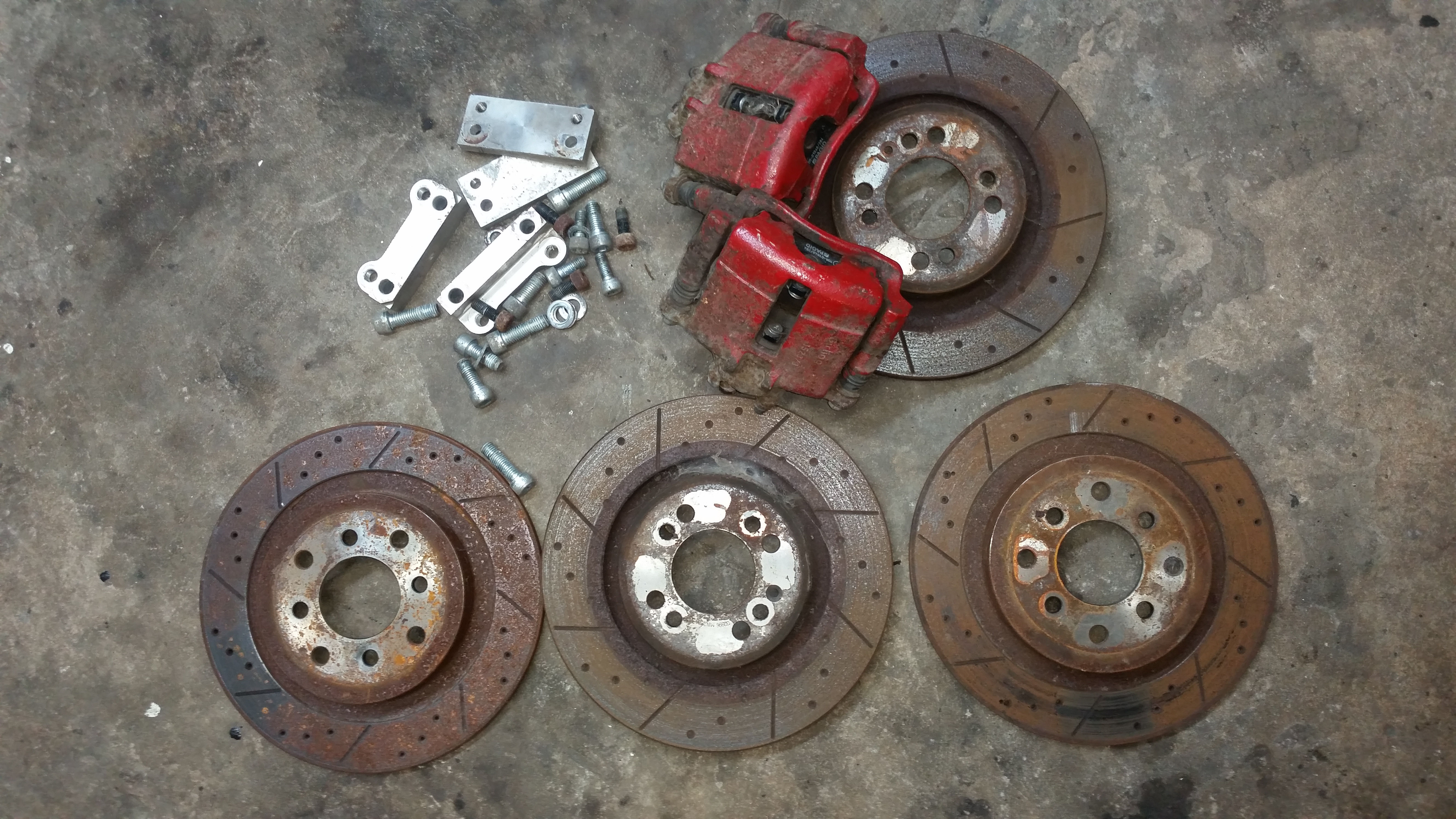

My new old old new old brakes from an mgf.
280mm of stopping power

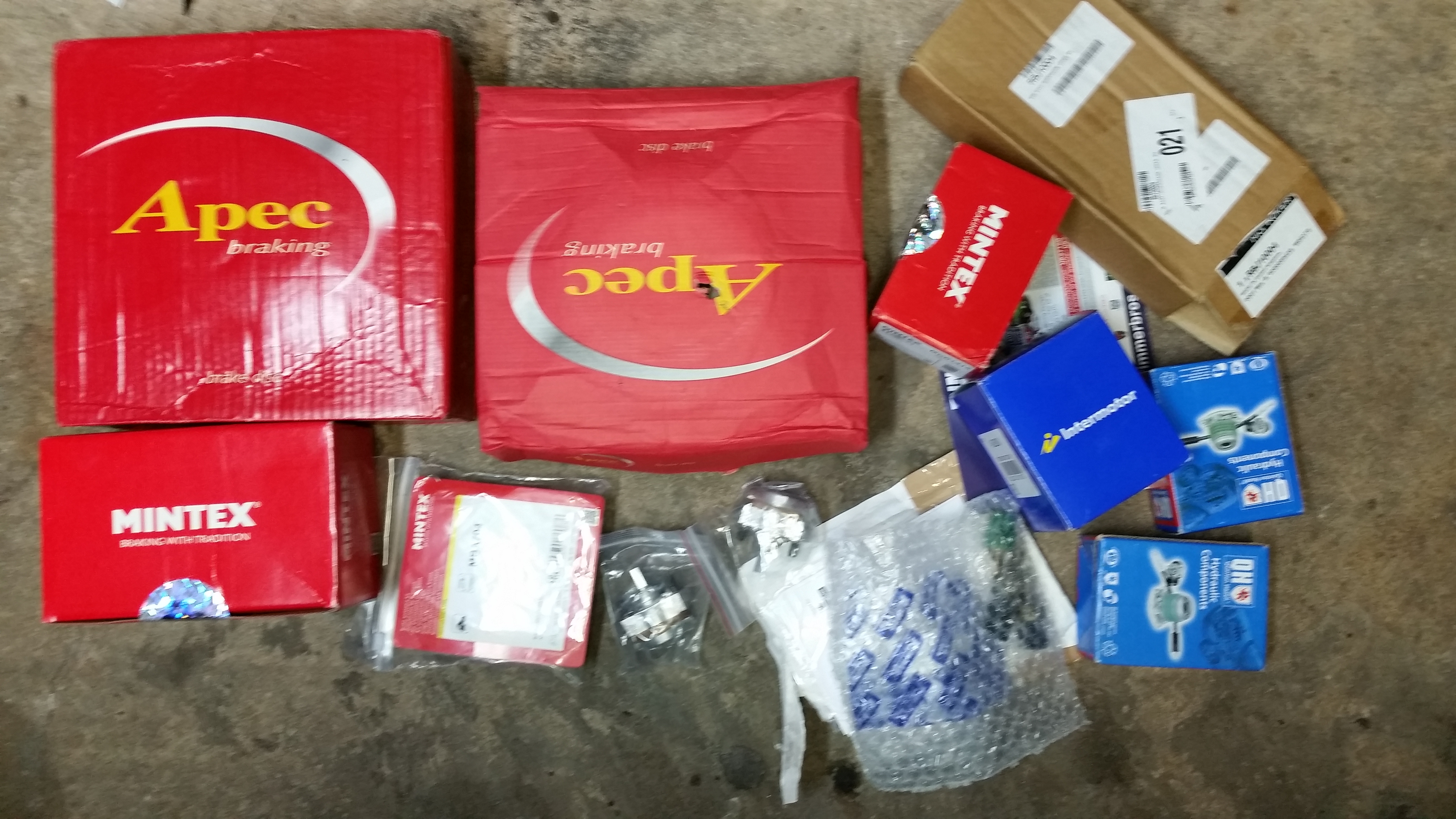

Post by Jin »
It's like Christmas :D

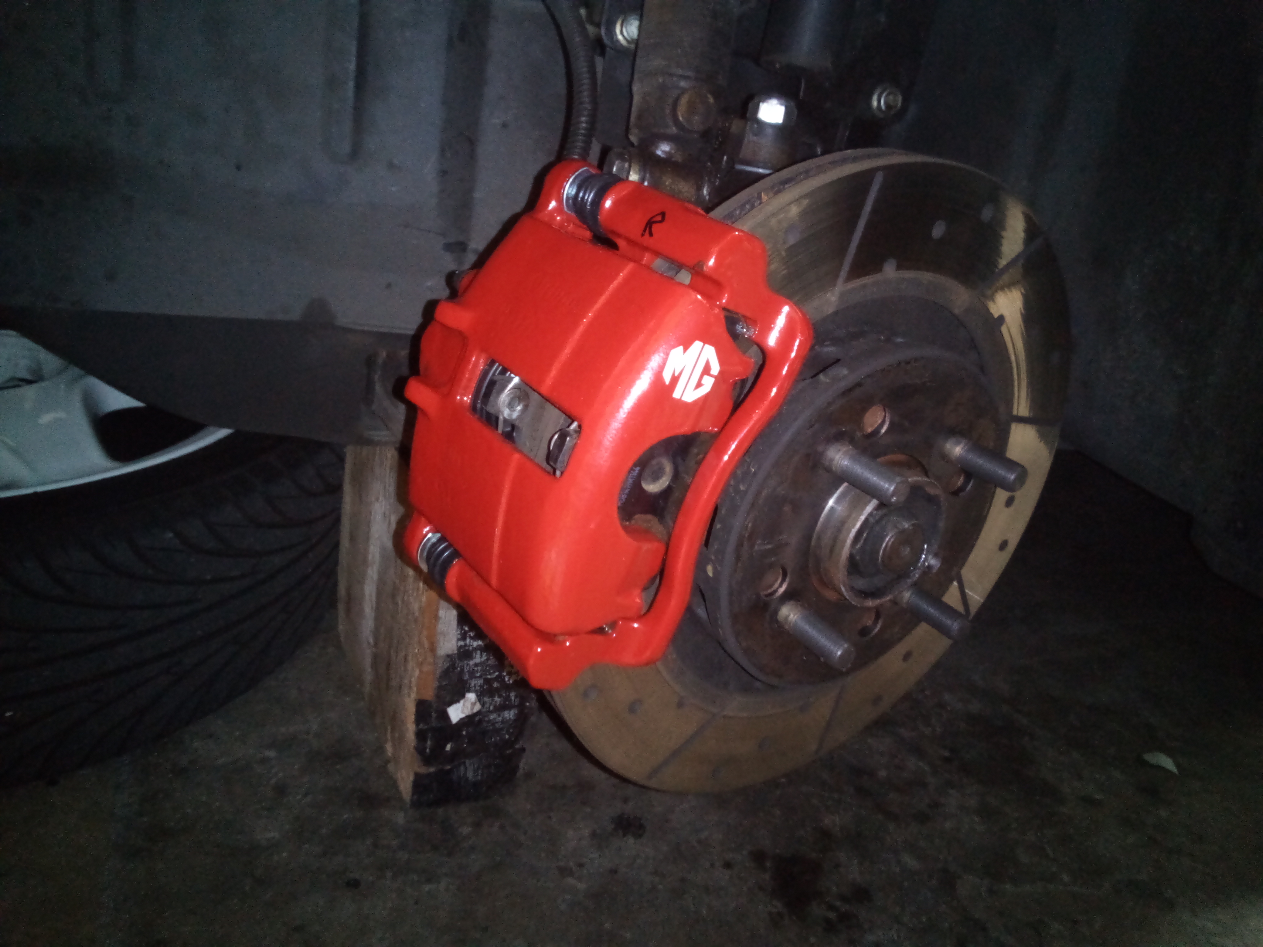

Post by Jin »
It's been a while since I've updated this and I'm still seeking out an alternative to photobucket.
However in the meantime all images as re viewable on Facebook so all should be seen
Anyway new brake calipers

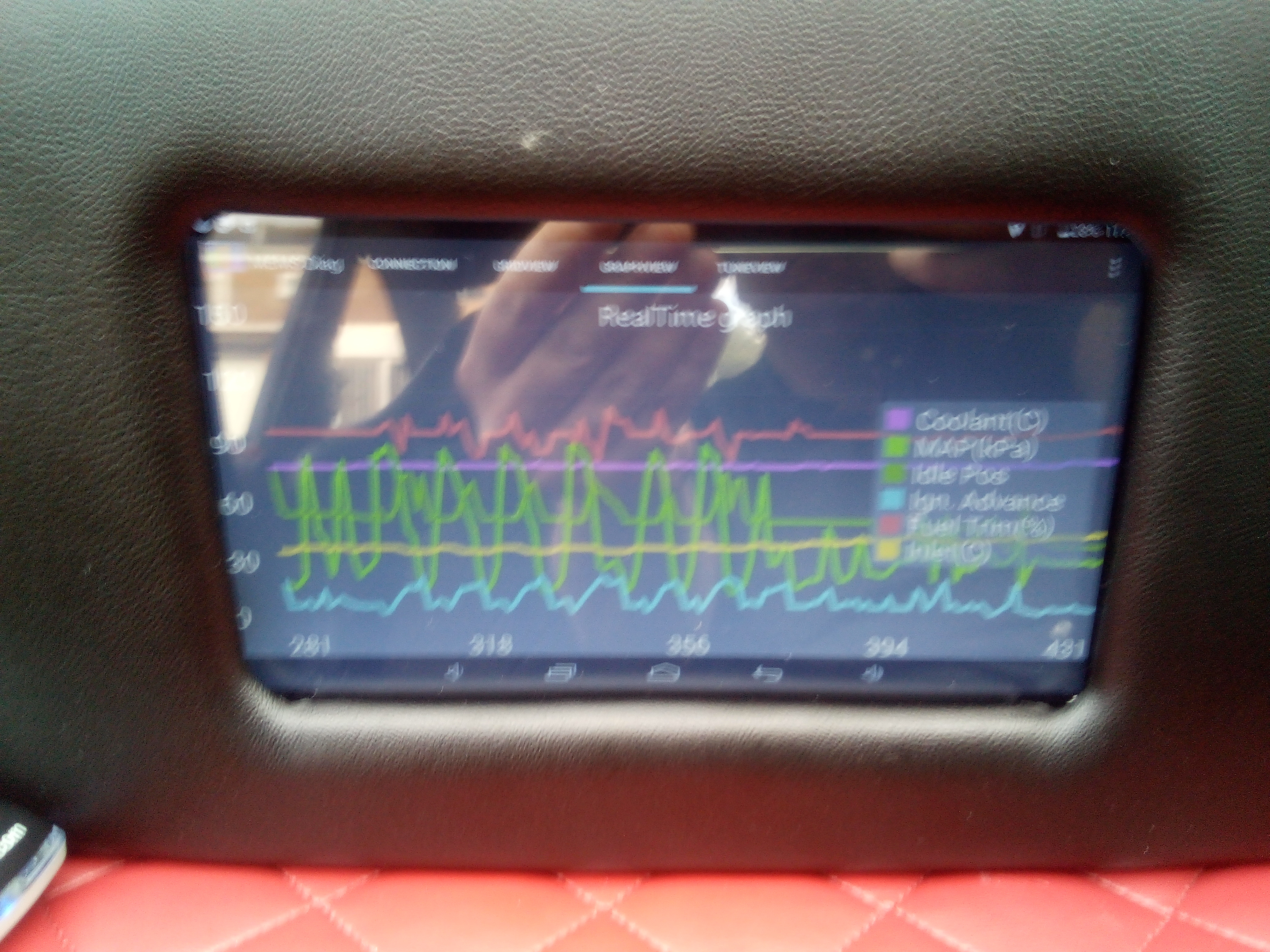

Post by Jin »
Touch screen dashboard and diagnostic system
