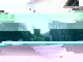

This car reminds me of your car
It is the current fashion to have a car that is that low as to be almost undriveable on any road that isn't completely smooth and flat, they sacrifice ride and handling for the look
Copy of DSC_0411.jpg (101.26 KiB) Viewed 7984 times

Nothing wrong with that ride height. Mine's pretty much the same but with 14" alloys
