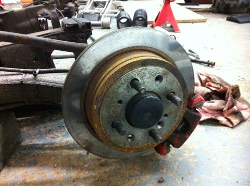

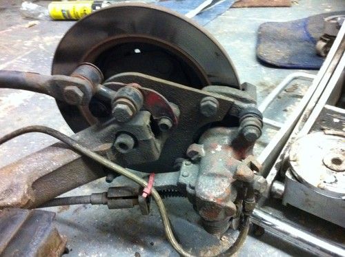

Re: Rear Disc conversions
What's that rod going off to the left?
Geoff Butcher wrote:What's that rod going off to the left?
Metro turbo anti-roll bar I imagine. ;)
