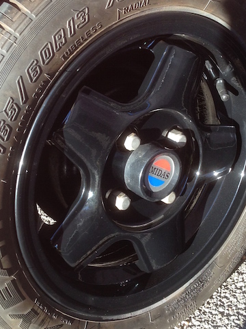

The cosmetic refurbishment has started: Just had the wheels powder coated in gloss black. They dont look good with the current body colour, but will look great when it is bright yellow next month !!

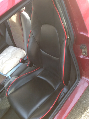

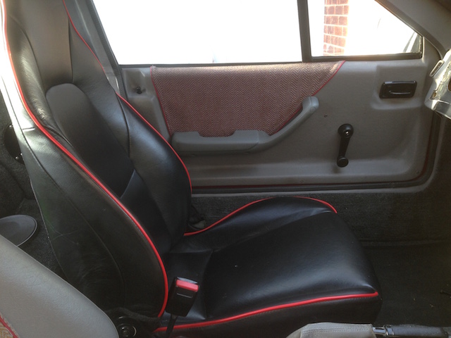

Trial fitting of one of the replacement MX5 seats....looking good !
Re: Mk 3 Q705CPF
Seats look to be a good fit. How much did it cost for the wheels to be refurbed? mine are well shot

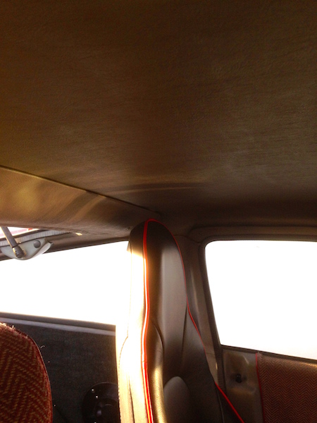

However, I remember reading somewhere that the later MX5 seats - like those in your photos - were too high backed to fit in a Midas without touching the roof; I suppose that comment must have been referring to the Bronze/Mark 1/Mark 2 Midas.
So, how much of a gap is there between your headrests and your roof lining? Any chance of a photo?

wheel refurbishment cost £60 each, this included refitting tyres, new valves and balancing
as for the MX5 seats, they are tall, but there is a gap of 2inches between the headrest and the roof! I do not have rear seats so do not need the tilt, and anyway might be a problem with them being so tall !!
I will do a photo later

Just thought I would share my experience of getting my mr2 wheels powder coated.I had various quotes of what I considered to be too high a price,and went to the Newcastle Wheel Company with them loose in the back of the car. I had a chat with the owner and said I had always been told £50 per wheel and it would be cash.Without even blinking he said yes.They made a fantastic job and it transformed the look of the car.I would always haggle and be prepared to walk away.If they want your custom you wont get out of the shop! Thanks,Stan.

MX5 seats roof clearance photo !!
tight, but ok, as I will rarely, if ever, need to tilt it for rear load space access
