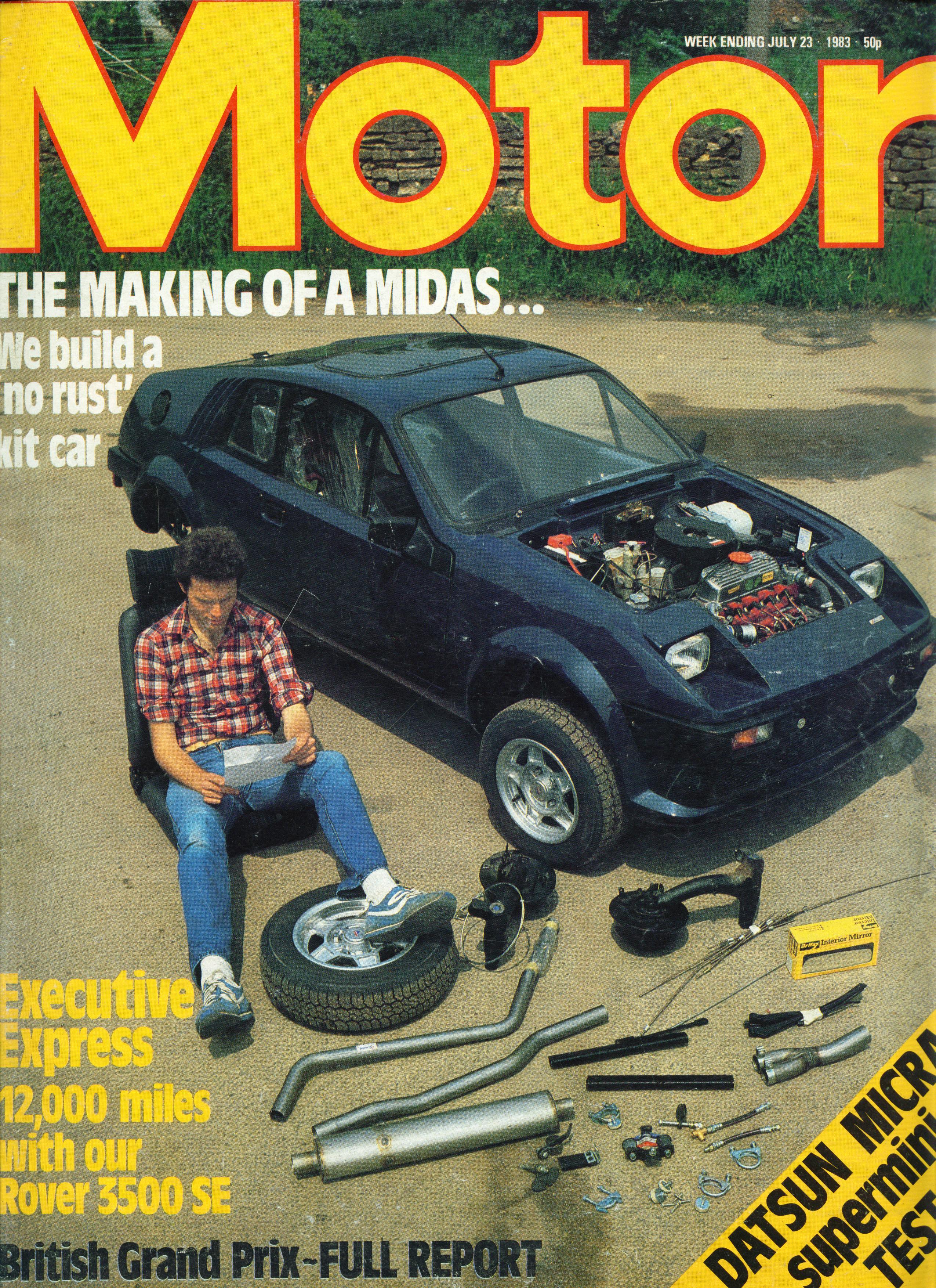

I am very curious about your exhaust, have you more pictures from your exhaust?

Indeed it looks fabulous.
The exhaust looks like a standard Midas stainless system like this.
motor 0783 p01.JPG (2.48 MiB) Viewed 62360 times

Thank you gents for the kind words and praise, I must admit the advice from members, tips, information and other projects found on the forum I have found invaluable and has helped me immensely. You are correct Stuart it is a standard Midas stainless system and thank you for providing the pictures, it has saved me scrawling under the car again. ( I owe you one ).
