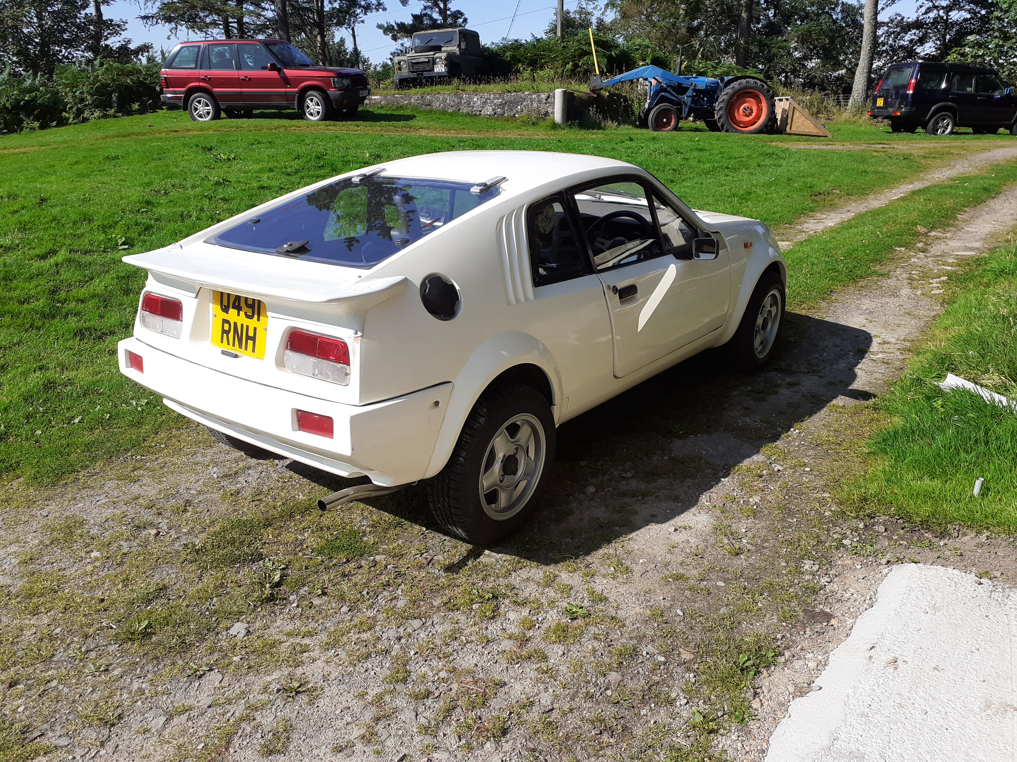

Well, nearly six years after buying the Mk2, and having never driven one, I finally got it away for MOT.
Failed on emissions....didn't think it was new enough to require such nonsense! So, out with the colourtune, hopefully I'll be road legal tomorrow!
Here's a picture or two......

And it's an absolute hoot to drive!!
Should be great on these empty Highland roads.
